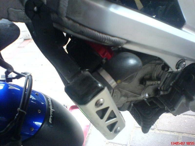

Originally Posted by KnightRider View Post
Where has everyone else put their horns (even if they are not magnums)?
For a curvy, but could you do something similar for the pointy? Goes at the top of the rad mount within the fairing.
Old 13-02-08, 08:41 PM   #7
orose
Default Re: Stebel Magnums - where to put them (Baph please read)
I presume that when you say its a sport, you mean the full-faired pointy job.
If so, a little bit of persuasion and a bit of bent angle-iron means you can mount it behind the LHS fairing with the horn itself pointing downwards, on the fairing mounting bracket (frame-end). I haven't got any pictures at present, as my bike is still awaiting repairs - it was still attached there when it went in, however.
That is exactly where mine ended up.
Indeed it is fully faired. I like Stu's idea of putting it behind the radiator but not sure that two of them will fit?
