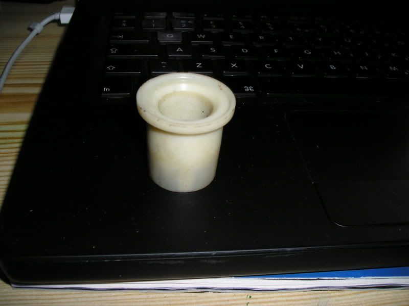

Here's one I made earlier:
You have to grind off the waste metal holding it in at the bottom of the tube then push it out:
There's a plastic bit inside that's a bit fragile but if you use a socket or tube just a bit smaller than the fork tube then you won't go near it.
If you need to know anything else just let me know.

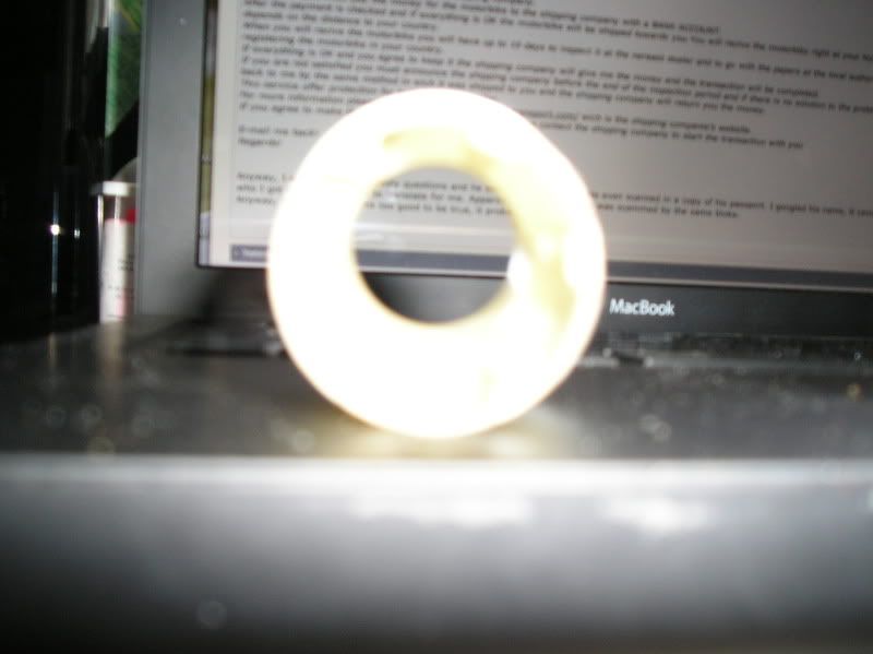

This bit, the plastic bit is an internal part of it, looks similar to the oil lock piece that fits on the end of the damper rod.
The whole thing is only about 5cms long.

No, it's not that bit. It's not plastic it's metal, it just happens to have a plastic bit inside. I've probably confused matters by mentioning it.
I need this bit complete.It's not something that'll unscrew or drop out you'll have to physically remove from the bottom of the tube.
I'll get you a better picture of one in location if that helps.
