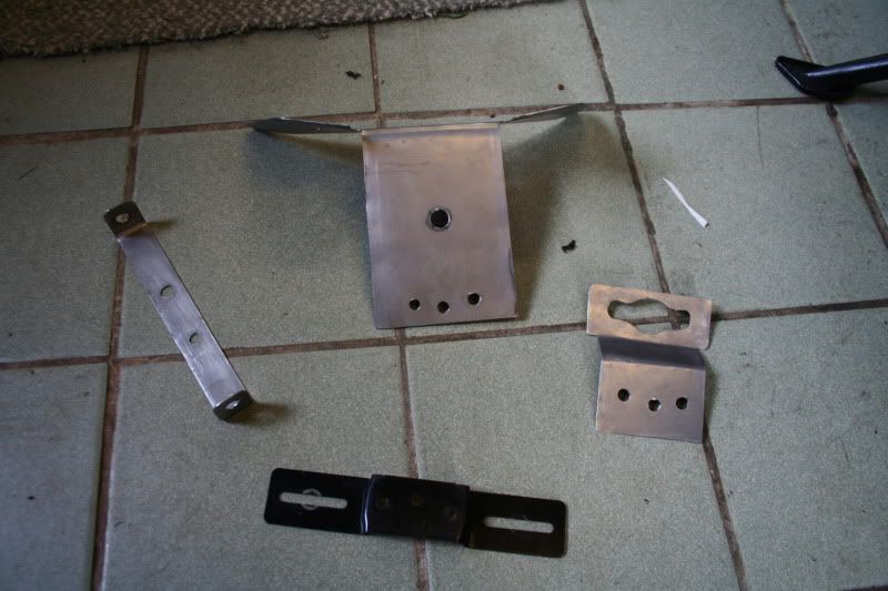

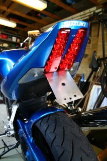

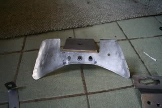

OK heres the work so far if anyone would like to know
After figuring the best way to mount it all up i started cutting some brackets and bits and bobs. This is what i have so far. I will be using the original mounting holes, with some longer bolts.
The tidy will be mounted on the exterior with silicone and rubber for water proofing and vibration reduction.
I used the guide on SV650.org. The link will only go to the main page, some of you will recognize it. I created brackets for the plate illuminator as well to keep it all legal, as well as little wings for the indicators.
First coat of Hammerite is on. I'm gonna source some heat shrink stuff for the indicator wiring, as well as using grommets and silicone/grease to keep the moisture out of the ECU etc.
