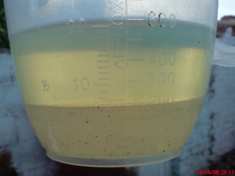

Well my sv packed up again yesterday, so investigated last night. After fighting with the rad to get at the front spark plug for about 3/4 hour, I gave up & decided to drain my carbs first to see if the inevitable may have happened.
The answer was yes, the carbs were full of water AGAIN . I pulled the tank off & drained it & once again found this

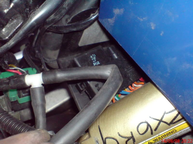

I was livid, telling my Sv what a pile of Japanese rubbish it was & if it didn't sort itself out it would be sold. I never had this trouble with my old one. When I went to refit the tank, I found the problem.
I have now made the hose longer so it isn't kinked. Started her up last night, ran her for about 15 minutes, to the neighbours disgust & went inside when all was well.

Replace with a braided hose, it won't kink.
Although I would say the main cause is the routing of that pipework!

Yes I think it was since I cut the battery box to fit the ZX6 shock. I will try & re route it I think
