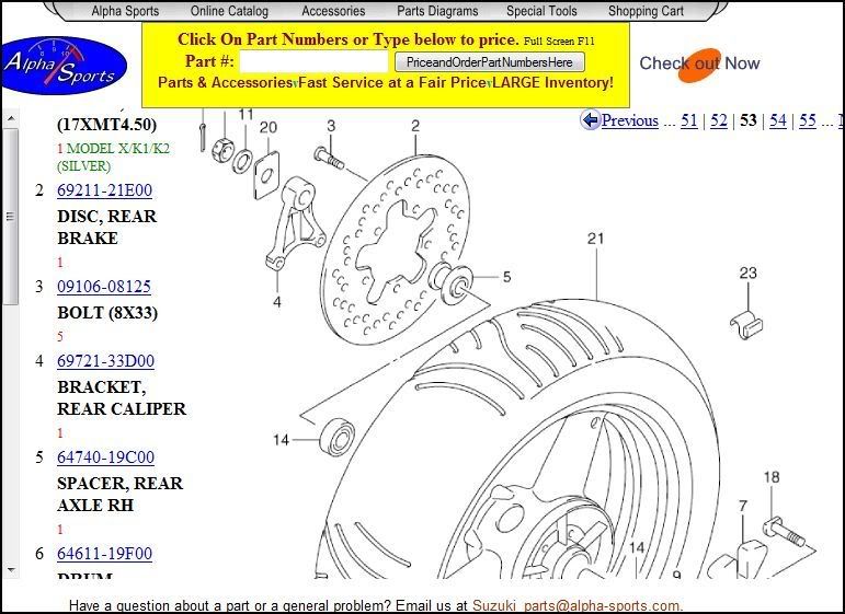

I cant find what i'm looking for so here it is . My 2002 sv 650 rear wheel suddenly likes to rub the rear caliper. The rear brake was seized and I took it apart and cleaned and reassembled it. The bike is used(beat)daily for drag racing and commuting to work. she has about 10500 miles. She has new sproket and chain.I' ve checked and tried reassembling rear end but still no luck. What do I need to fix her.

Sounds like you are missing a spacer or you have reversed the caliper hanger.
Can you take a picture?

the caliper looks like the pics so its not reversed. how many spacers are there? 4,5,14 look right but is there one or two 14s.

also my caliper hanger is curved is that normal. I looked at better pics of diagram and it looks like mine there is lot of play in cush drive
