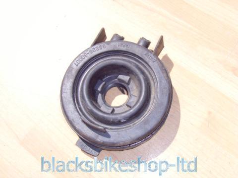

Pull the square connector off (pull it straight back), and then remove the rubber cover, unclip the the bulb and the pull out the bulb.
Rubber Cover

Its supposed to fit quite tight so it doesn't vibrate off, you need to pull it straight backwards too.

And the rubber cover on the back can grip the connector a bit. When it comes off you'll know - you have skinned knuckles if it's that stiff
