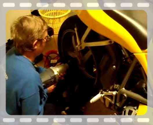

I just bought a Power Wrench from Netto as the Dukes rear wheel nut is 154Nm
This is it in action. Click on the vid link.
http://s72.photobucket.com/albums/i1...arwheel001.flv
Only cost 20 quid. Wish I'd had one for undoing the Sv sprocket nut and the lower suspension bolts.
Pete! You have a house elf!
Hehehe.
Nice find Pete, I might have to invest in one. The power wrench I mean.

Did you mean poor wench Sean or is it just your accent.
I need a breaker bar about 4 foot long to undo that rear wheel nut and the chance of the socket slipping off and scratching the wheel is quite high, so I've been on the look out for one for a while. Wasn't going to pay 60 quid plus for one though.
