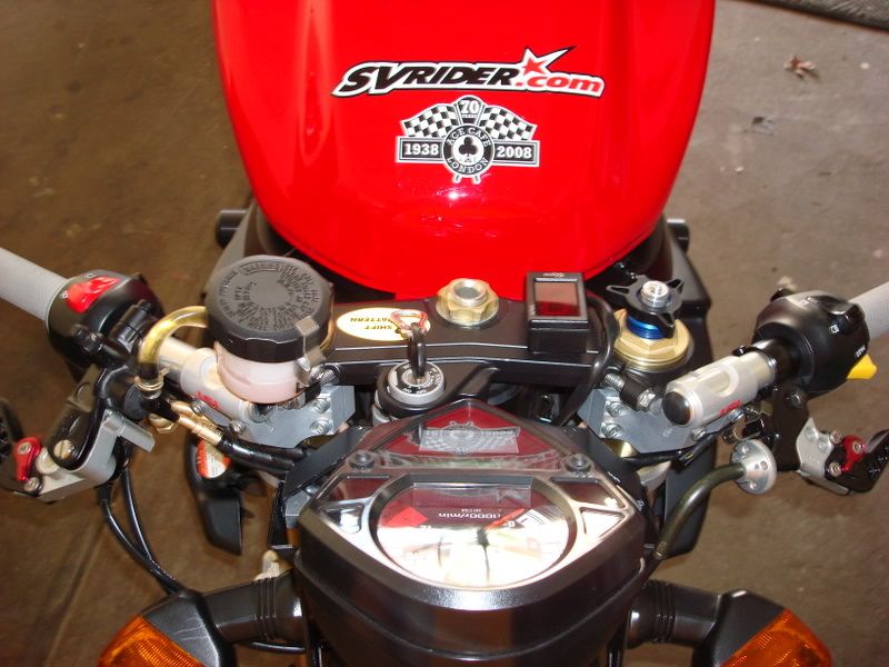

I need some raised clip ons. The TL ones are too sloped.
Something like this maybe. But I wanted to see what else they had

I have a set of those LSL Touring bars (for a TL1000S) on my 800, they are perfect for me and I think it may be Northwind that has a set too (not 100% on that).
I haven't any pictures of mine on this computer but I found a useless one on the web...

What about the little stud inside the switchgear. Did you have to drill the bar?
Old 30-10-08, 10:16 PM   #8
Sean_C
Default Re: LSL
Looking at the picture there are holes there. But you could always grind off the stud inside the switchgear.
Or, if it's the first time you've ever taken a switch gear off, you'll know when the stud is gone because you'll hear it snap off
Old 30-10-08, 10:17 PM   #9
Dangerous Dave
Default Re: LSL
Oh, yeah... nah just lopped them off on both switch gears. They will stay in position without them, also allows you to pivot them a bit for more comfort using the switches. You can use a thin layer of tape underneath them on the clip-on for added security, not necessary though.
No holes on mine, only came with a nifty bit of bent metal to mount the master cylinder....
