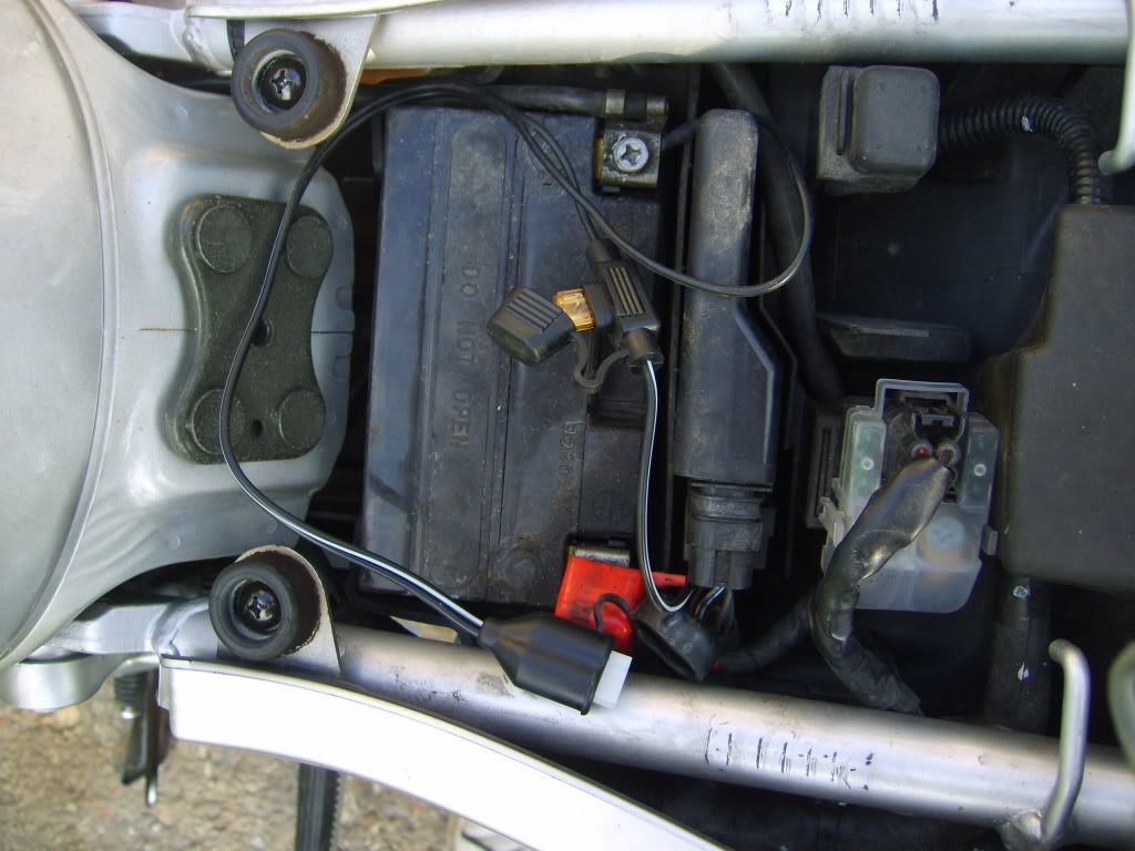

I found this attached to my battery, is it for optimate? has a 5 amp inline fuse so i could butcher that connecter bit off the end and use it for the horn? ( i dont have an optimate)

Yep, that'll be ideal. get some insulated spade ends to make the connection to the relay.
Maplins should have them.
I fed a wire off my stebl to the fairing backet for the earth.

Just a thought... The Stebel will kill that 5A fuse. Your horn won't work for long if you use a 5A fuse.
I think the stebel is rated at 20A, but double check this.
Old 01-05-09, 07:06 PM   #7
Default Re: Horn Relay
+1 Mine ate the 5A straight away, but I replaced it with a 7.5A and that's still fine
