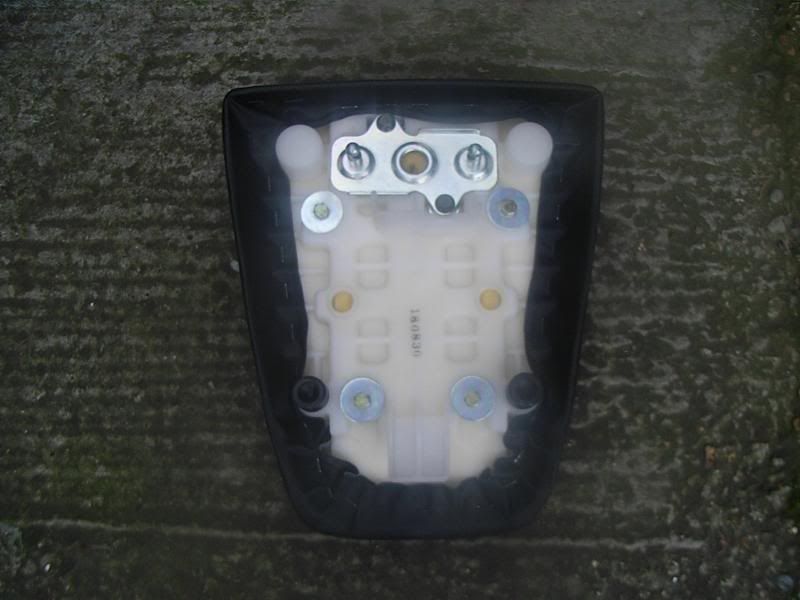

Step 3:
With the topbox mounting holes marked on your seat, drill through the seat sponge and the plastic on the underside.
Holes drilled on the underside of the seat
You can also remove some of the seat padding from the centre (but not the sides) to allow the seat to 'bed in' slightly more if needs be. This isn't completely neccessary but I like to be special..
Step 4:
Now to mount the box to the seat. I used the washers and mounting brackets which came with the box...
The topbox fully mounted on the pillion seat.. Mine came with a bit of material to line the box, which seems like a good idea as there are other unused mounting holes where small items could fall through..
