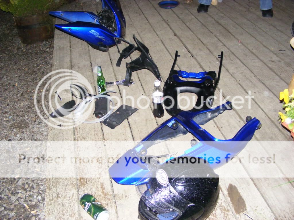

i thought the grab rail comes off??? Badger will know... he has one.
Dave
o hang on.... i am wrong.... there are two plates at seem to fit round the grabrail... see the picture below...
