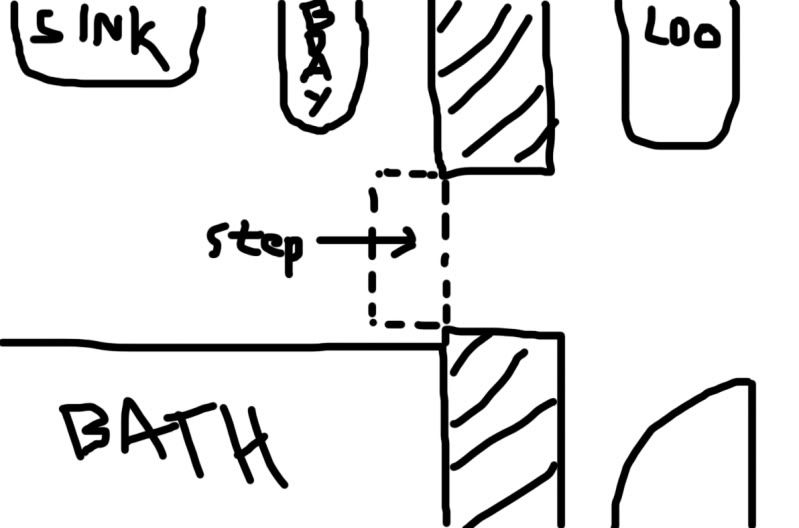

TBH the shape of the room is pretty weird, (floor wise anyway) the door/toilet are on a raised section with plywood over the floor boards (no problem there then!) and the lower section is a concrete base.
that is the shape (kinda) Was thinking of starting along the bath as the tiles are pretty large and two slot nicely in between that and the sink?

you my friend, are a C.A.D genius
Ha, dont you know it!
Oh and thought i should ad, they are in fact granite tiles if she could make my life any harder im sure she would!
Oh and just had a look at the pipework, its all proper pipework so to lift them up would need that extending, not to mention the fact i can not for the life of me see how they are fixed down to the floor .
