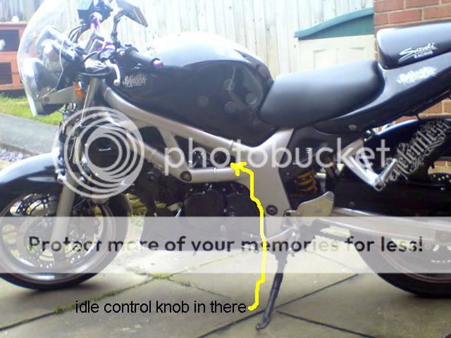

Well 1000 revs ain't high enough. The idle screw is on the left hand side of the bike
Its a little flower shaped kn0b.
I have two SVs and both do the same at 1000 revs. I have a VRaptor 1000 which has a higher setting for tickover, if it falls below it does the same. The revs need to be set properly anyway. As Sir Sid of Squid said, gummed carbs, siezed choke plungers can all add to problems.

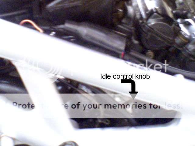

you pointing at wrong bit there... that is the top of the camchain tensioner, do not try and adjust that!!!

its the only pic I could find, and it is in the area between the frame, which is why I said it was a little flower shaped knob.

Idle control knob on left side of bike rear of frame pictured turn it to increase idle. sorry pic a bit naff.

Yep -it's just off the edge of that picture to the right.
