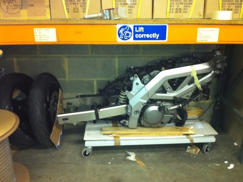

The bike got Smashed up 2 months ago so I thought I'd go for the gsxr frontend I wanted but didn't take the plunge. I've gone for
k2 tho forks with 750 k3 top yoke
Hayabusa tokico 6 pot calipers
My sv galfer lines
Tl1000 clip ons
Srad 750 front wheel with discs
Honeywell sensor from rs
As this set up does not bolt straight on if had alot of running around and Agro but the end result has been worth it as I have a matching front wheel to the rear and nice big brakes
I managed to get panels I needed and sort out the spares I had. As this was being done on a budget I gave spraying the panels myself a Toyota e53 red. While I was at it I gave the engine a coat of vht metallic grey

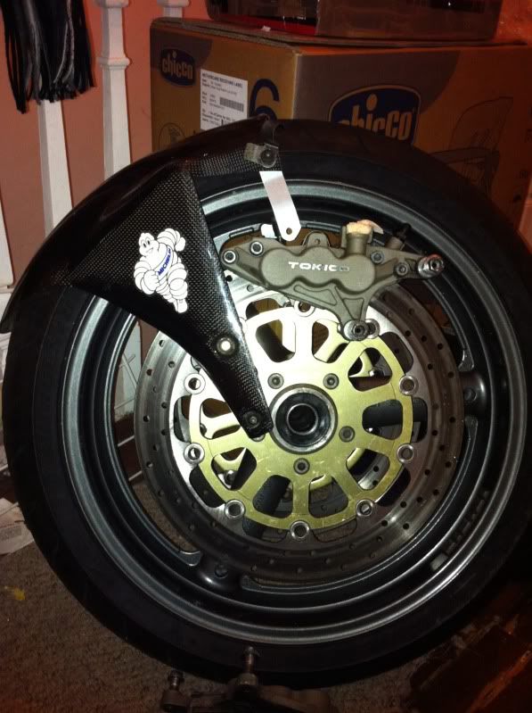

Started getting the front end to work by turning down the front spindle and making a spacer to bring the wheel centre to the forks. Once that was done mdf templates were made to mount the calipers and house the speedo sensor. These were then sent to the Cnc guy to make the final product
Wheel powder coated and new bearings/seals
Bearings/seals in and disc's fitted
Caliper hangers
Had to remove 2mm from the caliper mounts to get them dead centre to the disc's
All centred.
Speedo pickup fitted
All done and ready to fit to bike.

Love the MDF templates

Lovely work there

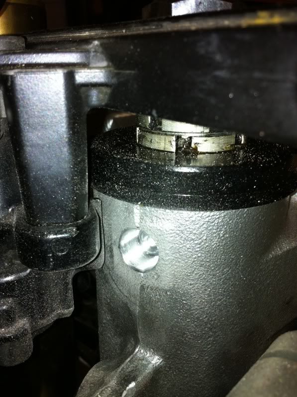

I enlarged the hole in the frame for the lock stop as it was only afew mill out
I found nothing seems to line up or clear as the bottom yoke was catching on the fairing, all the headlight loom, hid loom and heated grips makes it a right mess and in yet to trim it back and give some better clearance.
I need to drill and tap the bottom yoke as it has no stops and the steering is just odd without them.
It's all built and ready to go other than making everything clear and fine tune the speedo sensor as it's over reading with 4 magnets on a 9 spoke disc anyone have any ideas?

Can anyone help with the over reading of the speedo?

Try increase spacing of sensor. It may be picking up on disc bolts or rivets as well as magnets.
Lovely work, can't fault it... except for being very puzzled about why you would get probably £100s worth of CNC work done rather than just buy some GSXR1000K2 calipers?!

Speedo healer will sort it
Old 19-11-10, 10:33 PM   #9
Default Re: K3 650 with a gsxr 1000k2 front end
Speedo healer will but it is just a band aid... couple of washers are easier to try first of all!
Old 19-11-10, 10:35 PM   #10
widget
Ah ha that makes sense I have got it set very close will have a go on Monday when I'm back at work
