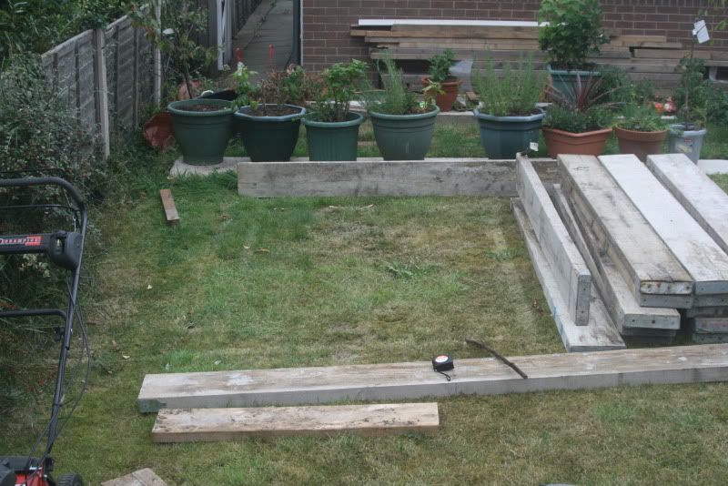

Start with one piece of garden, measure the site, buy some wood. These are old scaffold planks I bought from a farmer in north Shropshire. They're imperial sized, 2 inches thick, 8 feet long and about 8 inches across:
Next, deturf the site. Now the eagle eyed of you will immediately notice the howling error here, but if you don't then read on, I come to it in a minute. It was doing the deturf when I realised 'this ain't gona be so easy', the ground was rock hard:

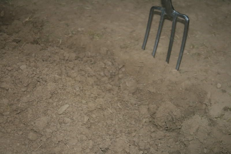

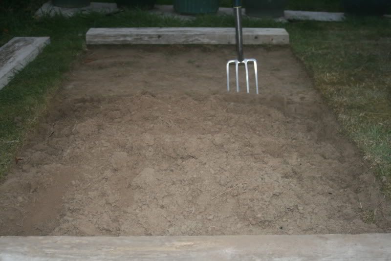

Then, dig for England. This is nec cos the soil is so compacted, you may as well have a concrete base if you don't dig. Look at this desert:

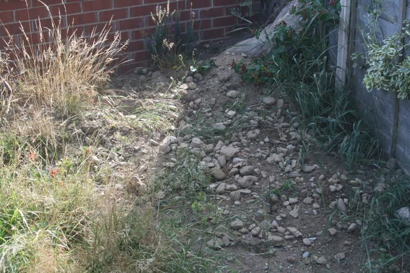

I threw the stones to another bit of the garden, now looks like the surface of the moon:

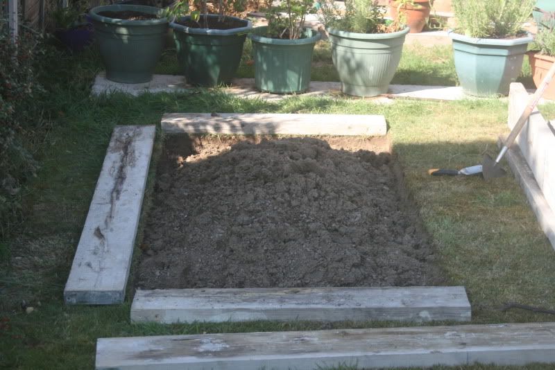

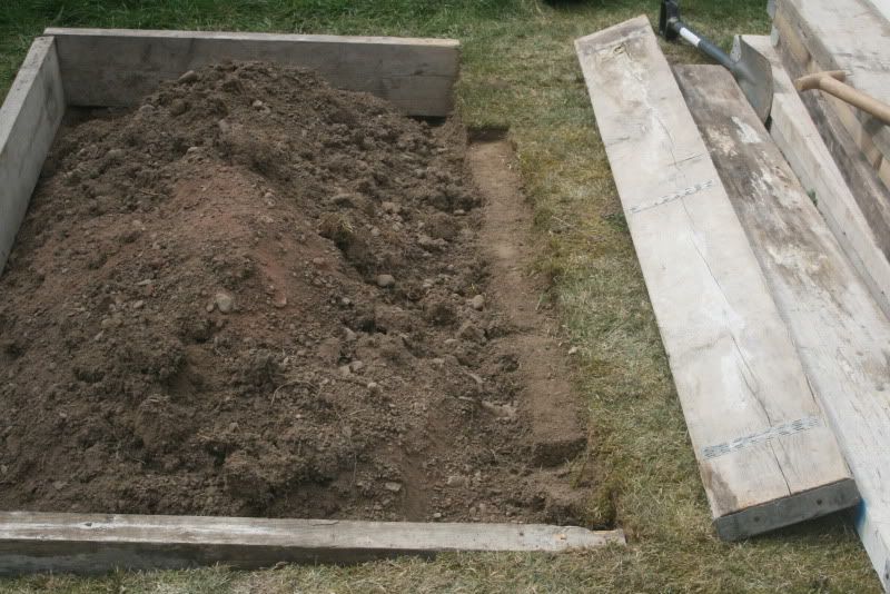

Then fit your timber for size, and check that it's level. I had to dig into the slope to get this right, f*ck it was hard. It would annoy me if every time I looked at it I thought 'Damn that's not straight'. Those who didn't spot the c0ck up, can you now?
I didn't add the thickness of the plank, so I had to dig out another small bit. Grr.

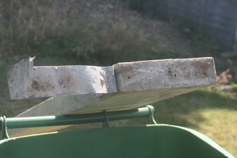

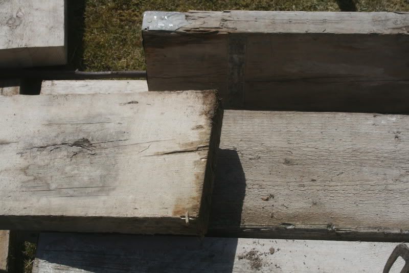

Then, take the metal ends of the planks:
They're damn sharp!!! Like razors, finger hazard!!

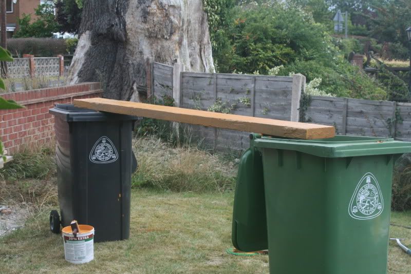

Paint your planks, the wheely bins make great supports:

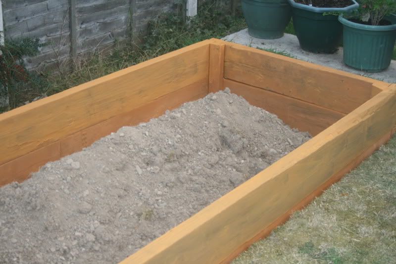

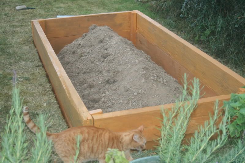

And then shove em in the ground!!!!!! Because the base is part sunken cos of the slope, I didn't need foundations as such, this beastie is going nowhere. I did two heights, and used some old 3X2 roof rafter from the build project as a support post, used no 12 4 inch screws, had to drill pilot holes first, then the screws went in a treat. It will look something like this:

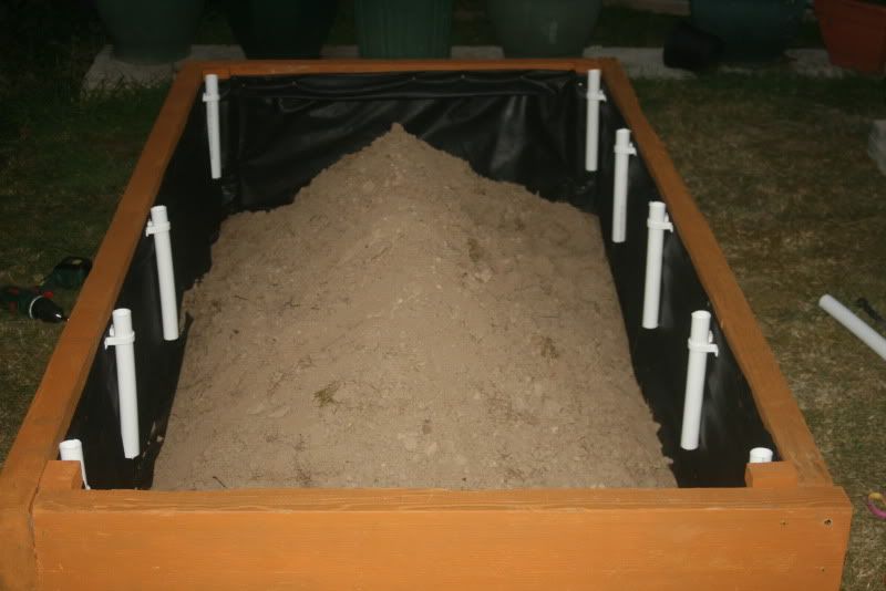

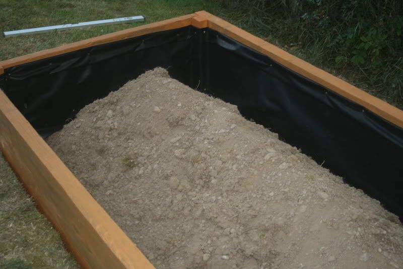

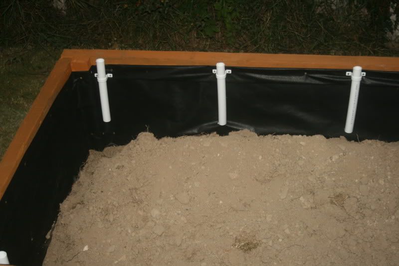

Next, cos I don't want water evaporating through the wood, and cos I don't know what Cuprinol put in their paint, and don't want it leaching into the soil, I nailed a double thickness of landscape fabric to the inside:
And finally I put in some watering pipe so I can get water below the surface. This is just a 3m 32mm drainage pipe from B&Q sawn into 30cm lengths and screwed into the sides with a pipe clip. I ran out of clips, dammit, I'm one short. These fellas have a double purpose, I'll get some 25mm alkathene piping to make a support for a plastic or fleece cover, to warm the bed in early Spring or to keep out carrot fly etc in summer.
And it will look like this:

Oh nearly forgot. Final stage is to get your cat to inspect your handiwork

Only advice id offer from experience is fertile soil will rot the crap out of wood, id use damp proof membrane instead of landscape fabric, i did that before on my planters and they rotted big time, mine were made of ash as well.
