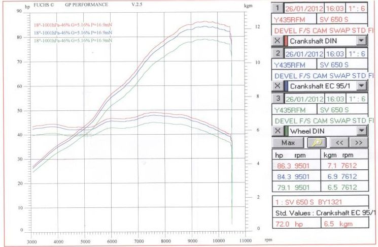

I did the cams, devil system on my bike (2001) and had it dynoed on base settings for carbs (not sure what but i THINK they are stock) and it ran at 79.1 rear wheel hp.
I then put my K&N filter in and the bike barely ran. So i took it out again and left it as it was.

Originally Posted by Serdna View Post
86 HP? I dont think so. Looks like a VERY optimistic dyno machine. Ah, is that showing at the crank?
