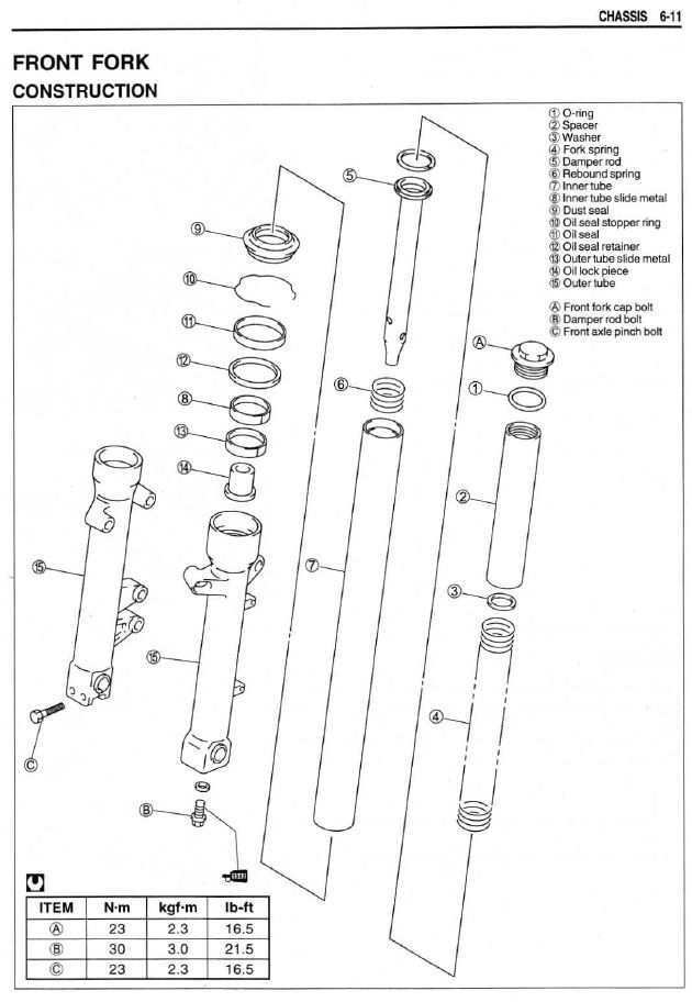

Not familiar with the SV forks (yet) but if the bearings are worn then the seals won't last. On my last bike that made a difference, even the condition of the lower bearings had an effect.

I was referring to the bearings inside each fork, the bearings that allow the inner part to slide inside the lower part. I'd need to see an exploded diagram, but I'd expect to see a replaceable bearing or bushing at the top just below the oil seal, and one at the bottom of the inner tube.

Its not something you can see from the outside. But it might not be called a bearing. If I'm thinking about the same thing as aesmith, its an internal ring or bushing which may be worn or damaged.
You would have to get the upper and lower completely apart to check this visually. If its cracked or worn, the stanchion may not get a good seal or might be rocking around in the lowers. The seals themselves may not be the problem.

Yes. Bush is probably the term, not bearing.

Hope this helps; is it items 8 and 13 here you're referring to?

ok thanks , will get a look at them , but as I said its just a very small smear of oil one the top fork part , so its not a big problem at the mow , thanks for your help

Sounds like it just needs a good wipe now and again, like before MOT. If it gets worse and you're replacing the seals, you can check those parts for wear while you're at it.
