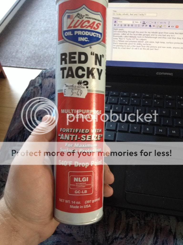

Right guys,
Got everything through the post for my rebuild apart from some Red Rubber grease, called all the local bike garages and no one had any in!!!
Eventually called Milfields Auto in Peterborough and they said that they had some "Red 'n' Tacky #2" for calipers.

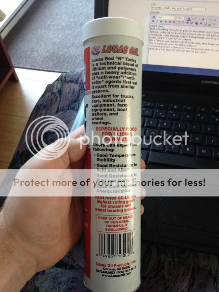

Its a "lithium and polymers blend", anti seize, high temp, surface protection that's especially good for sliding surfaces.
I'm planning to put a thin layer over the pistons and new seals, anyone else think its a bad idea? Or will it do the job just fine?

No. No. No
Definitely not suitable for hydraulics. Keep well away from your pistons
Red rubber grease is base on vegatable oil

Red & Tacky would work for a few miles but WOULD rot rubber seals
