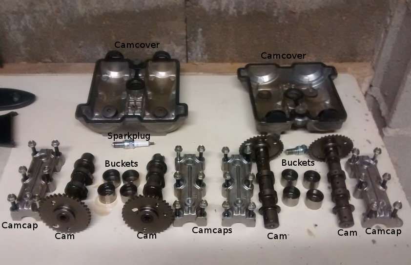

Could someone re-post that picture with all the parts labelled (apart from the spark plugs) for mechanical numpties like me?!

Just for you baby!
OK, maybe I labelled one spark plug a bit - the other one's hiding.
