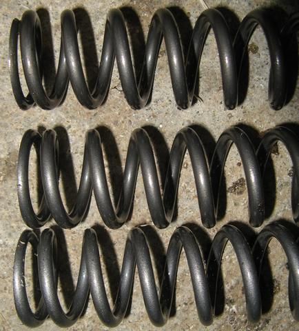

Hi,
I think I know the answer to this, but I believe in giving the benefit of the doubt where possible.
The question is .. should K-Tech 8.5 springs look visibly different from normal Pointy fork springs? For example different wire diameter, free length, or type of wind (standard springs have a touch of progression with closer winding at the lower end).
Would appreciate any confirmation, can post photos if it helps.
Tony S

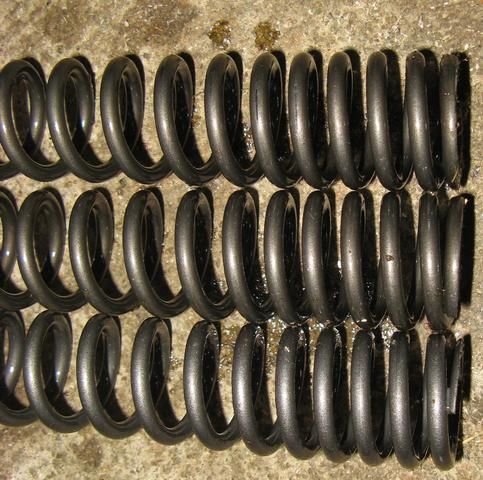

Close ups of the ends, two standard pointy, one supposedly a K-Tech .85 ...

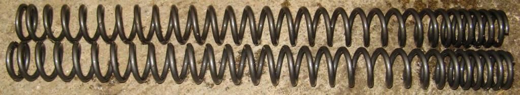

One standard and one "K-Tech" full length ...
I'm struggling to believe they are indeed K-Tech, are they? Same type of wind, wire is actually very slightly thinner, free length about 4mm longer. Standard springs off a different year SV maybe?

I have K-Tech .85's in the curvy track bike. They have a uniform wind all the way down and, I believe a 0.85 etched into the top.
Those look like standard springs to me.
