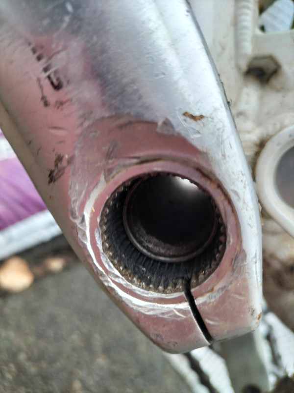

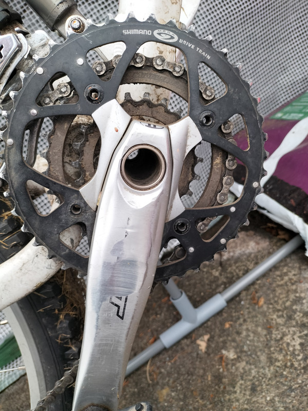

Bibs post a picture of the crankset. I've got a couple of hollowtech 2 chainsets knocking about if it's just for a get around. Octalink didn't last long, still required a special extractor tool and wasn't any better than square taper.
Hollowtech 2 uses 24mm spindle and pretentions using an end cap, secured with two bolts, is very simple and user friendly.

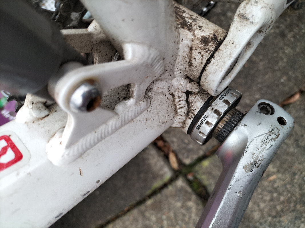

Default Re: Shimano Hollowtech
hi mav. the crankset looks identical to the hollowtech II XT but its the earlier one without the locking hole on the main shaft at the single arm side. the main adjustment nut is about 22mm instead of the 20mm of the II.
i would guess that the II would slide straight into the bearing set though.
ok i just looked at the top of the crank arm and it says ermm hollowtech II... wonder why the nuts dont fit. think i'll pull the arm off again at the weekend.....
