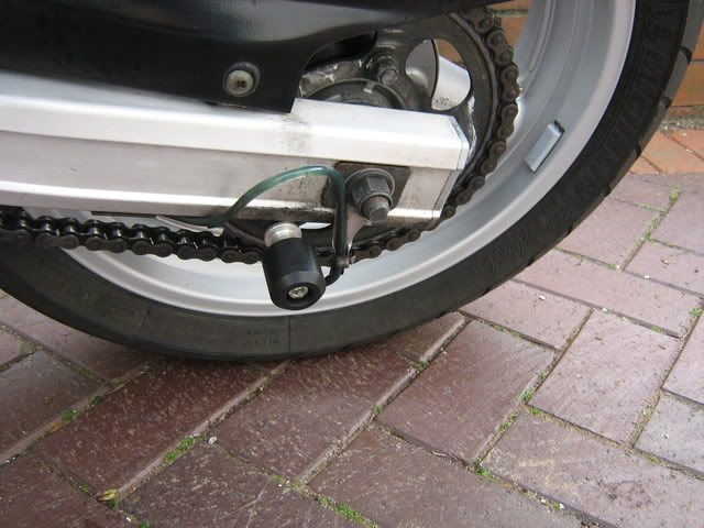

Trust the fact that the supplied super glue will hold the guiding plastics onto the bottom of the swing arm.
I fitted my ScottOiler almost a year ago - this is the only visible bit of it:

Originally Posted by ejohnh View Post
pic
Derail:- How on earth do you keep/get your rear wheel THAT clean?!!?
Old 29-03-08, 09:45 PM   #5
chazzyb
Default Re: Scottoiler fitting torture.
Self-tapper in the end of the delivery tube?
