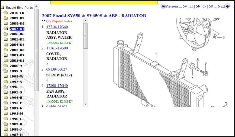

Hi, you don't say what year your pointy is. I did a check on Alphasport on a K7 and they appear the same for faired and un-faired. On the curvy the fairings clip into the rad and cover some of it, so a different one is required for the naked that doesn't have the clip-holes and fittings for the extra trim instead. On the pointy, the headlight fairing doesn't cover the rad so a trim fitting is required anyway. FD I've got my rad off of my old curvy. Straight.
Alphasports microfiche showing it's for an S and non S model ,K5 to K7 at least
