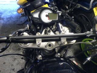

Now I have my "new" SV (curvy N '99, I crashed my previous) I want to replace my R1 front end from the SVS to the new SVN. But I have seen this will not be a common thing.
First of all I will need new brackets to attach the head light to the forks because the diameter of the R1 leggs is slightly larger than the OEM forks (54mm). But this is not the biggest problem, bike-design.com has some nice ones for sale.
A more larger problem is to attach the display. Stock it is attached to the upper yoke, but as my gsxr yoke hasn't got those holes (and I am not planning to make new ones into it) I will have to look for a solution. Anyone can think of one of maybee has experience in this?

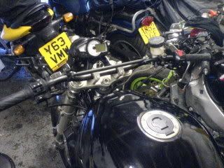

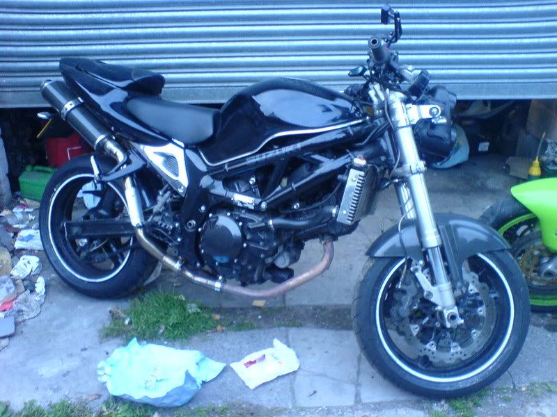

Got SRAD 750 Forks on mine,
For the clock mounting I decided to mount them the clocks directly yo the back of the headlight!
Depends what haedlights your running though. If you clocks are small and light then you can be more inventive with your ideas I reckon,

They're made by KOSO, its the RX1N Model I think,
The simple functions (like oil pressure,indicators, Neutral, Full beam, etc) wired up really easy! Only took about half an hour with a SV650 Wiring Diagram.
I'm currently left trying to figure out the rev counter, speedo and the low fuel indicator. These functions are quite important - but for now the bike runs and I just keep topping up the fuel.
I thought about mounting them on the top yoke but I wouldn't have sat correctly. They would've stuck out too far,
This pic shows how they sit in relation to the handle bars - I think it was the best place to mount such a small clock!
Thanks for the comment, bike is still a work in progress
Can you believe I've ridden it maybe 25 miles this year!!
P.s. -What colour heelplates do you think, Black or polished? Or maybe a mix of both?
Can you post a pic of what you have so far? The way I see it, its not really a streetfighter unless you have to do some fabrication to get things to fit!!

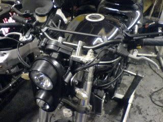

Here some pics of the brackets I will use, I hope you can do something with it.
Thanks for the help
