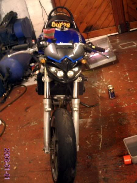

hey guys did that today and everything seemed to be fine..
got new plugs in it and its firing up first time every time tonight but i still have this awful feeling that tomorra morning in the freezing cold its gonna tell me to go F myself.
and hehe why does my sv have no clocks. how do i post a picture and i will show you why my friend

Sweet

theirs a picture of the bike as i work on it and one playing on an industrial estate with me girlfriend in 5th gear
