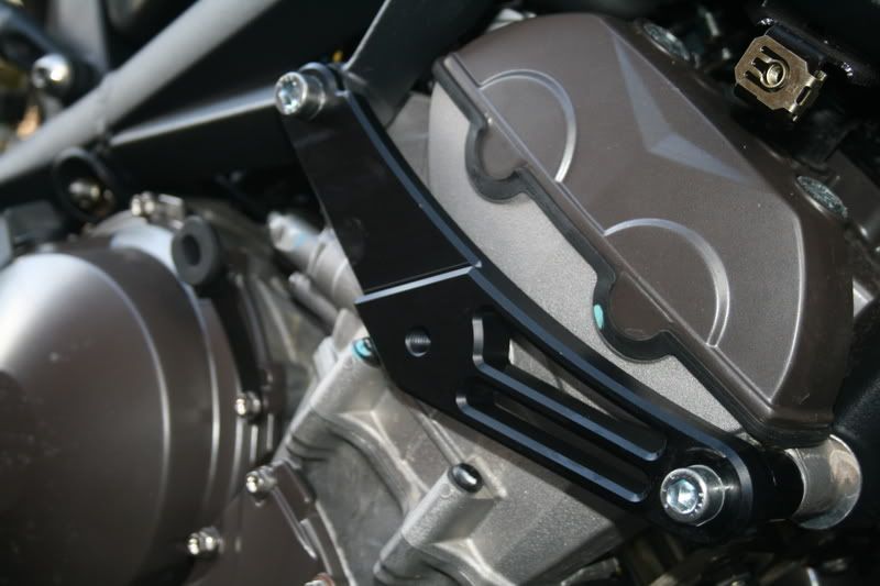

...they are so well made - no nasty casting marks, no unfinished rough edges, and whilst they're tight they fit beautifully. Needs two people to do it, as getting the engine bolts out is a fiddly job. John did most of it, he's a wiz with a torque wrench and a set of spanners, and has every toolknown to man, so thanks John
This is what's in the box:

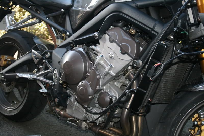

Right fairing off. Bike's mucky cos it rained yesterday and got covered in salty spray from the road. Needs a wash, didn't have time. This bike's for riding, not for polishing
The idea is that you don't drill the fairing. So you put a mount onto the engine - the longer bolts supplied with the kit bolt into the engine bolt points, and the slider then screws into the mount.

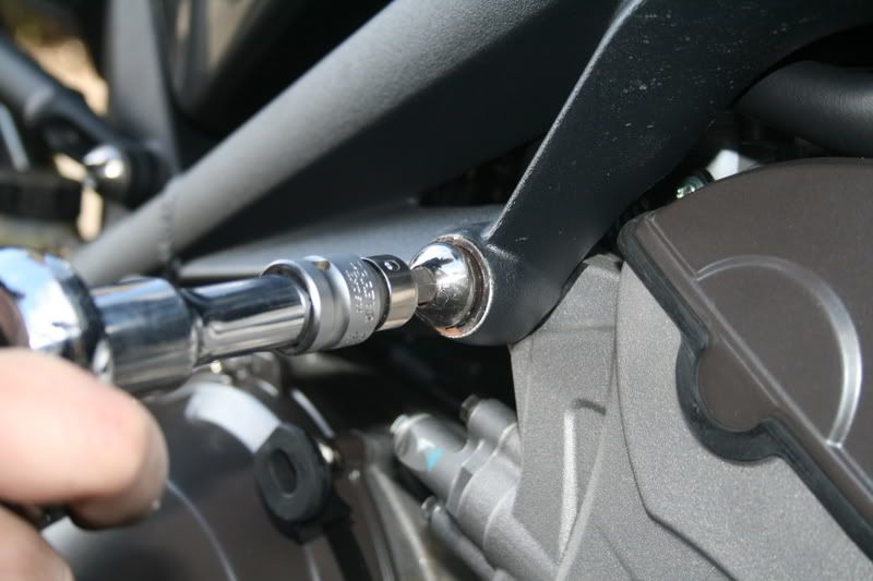

More detailed view of the right side. This next shot is with an engine bolt out. Getting this bolt out is a right fiddly job, you need two pairs of hands, as there's a retaining nut somewhere in behind. It needs a 13 (from memory) spanner to hold it, so you need to hold that (and it's an awkward reach) at the same time as pulling hard on the bolt to unscrew.
The other bolt is easier as there's no nut on the far side. This is John giving it wellie:
