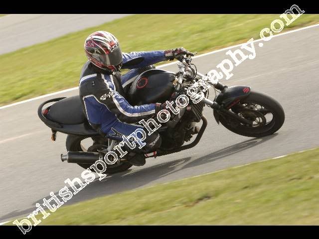

Jester666
Default Re: Clocks or no Clocks
Clocks aren't needed. I did Silverstone without clocks, lights or fairing.
