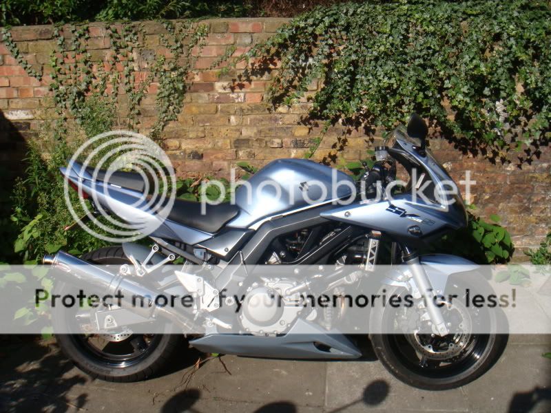

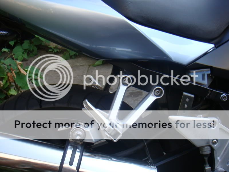

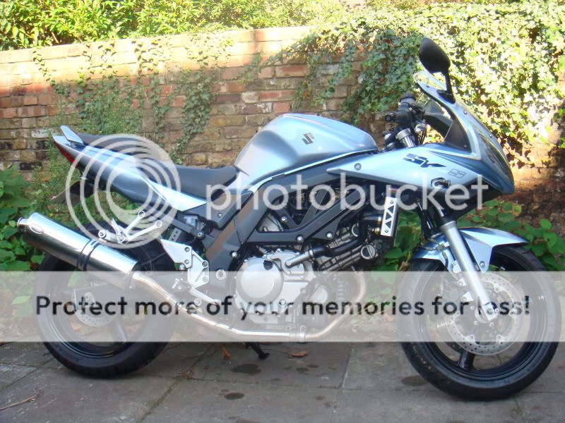

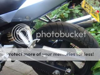

Hi all,
Well it has all begun and with some of the parts arriving this weekend I have started the makeover process!
My Canvas ...
And the first addition are the new belly and and hugger from Poly26
It has transformed the looks of the bike in my opinion!!
Have a look for yourself !
Watch this space as the bike goes in for a custom paint job on saturday and will then be followed by
Zero Gravity DB Screen
Tank Raise and SV1000 snorkel
Full Yoshimura TRS system
All stainless bolts
New Indicators
Rear seat conversion
Its gonna be a busy winter !!
Let me know what you think !!

Nice one. Really like a tastefully tweaked pointy.

Any chance of higher res photos? It's difficult to see any detail on the tiny ones you posted.

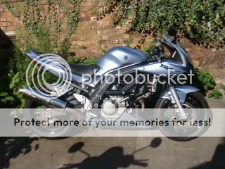

Old 12-10-08, 07:13 PM   #5
Stretch650
Default Re: Extreme makeover - Pimpin the Twin
Damn - how do i get them to show on the page ??
Hope you enjoy

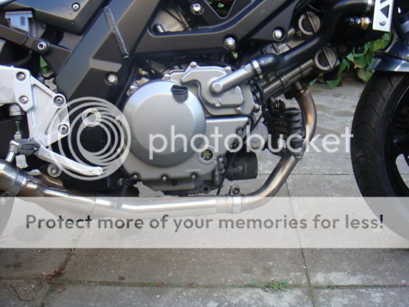

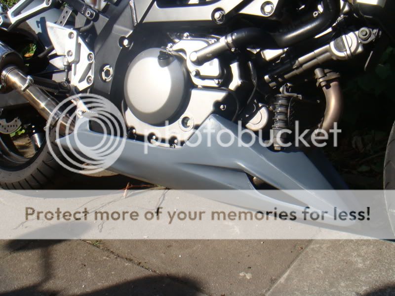

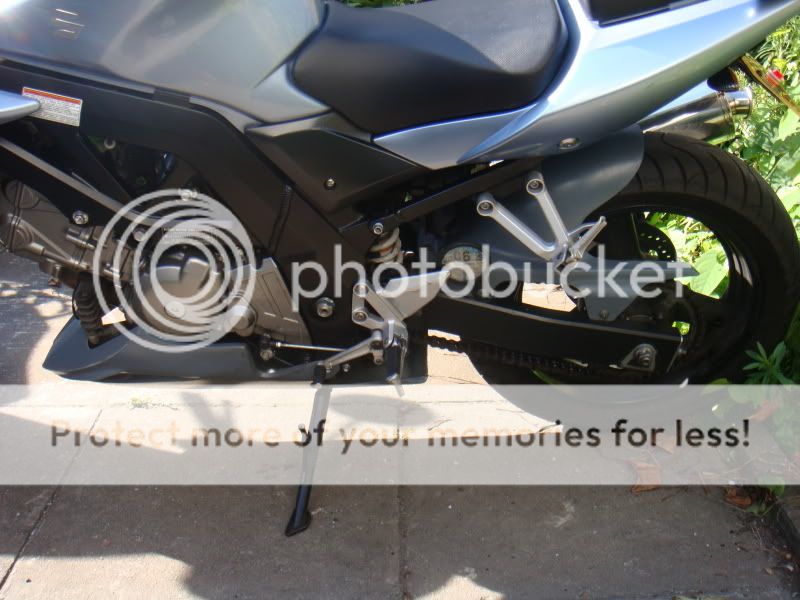

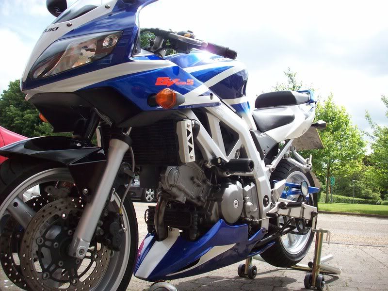

Time for the shameless promotion of my bike
They look great when they are painted nicly. Make sure you get the surface prepped properly becuase the finish can be abit rough.
Also, run it for abit, then take off the bellypan and make sure that there isnt any fouling against the exhaust link pipe. mine started to burn it and i had to use heat wrap to prevent massive damage. After a year the paint has finally started to bubble on the outisde due to the heat.
Hope yours doesnt have this problem!
Look forward to seeing it painted.
fancy another pic? oh ok, you twisted my arm!!
Now thats what I am talking about -cheers for posting it looks awesome! So many people have tried to persuade me not to paint but i think this clearly shows that done correctly it can look mint!!
