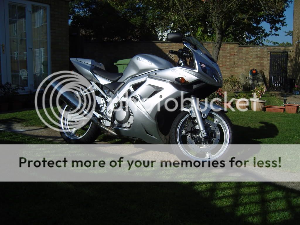

I'd been meaning to join and get some pics of for a couple months.

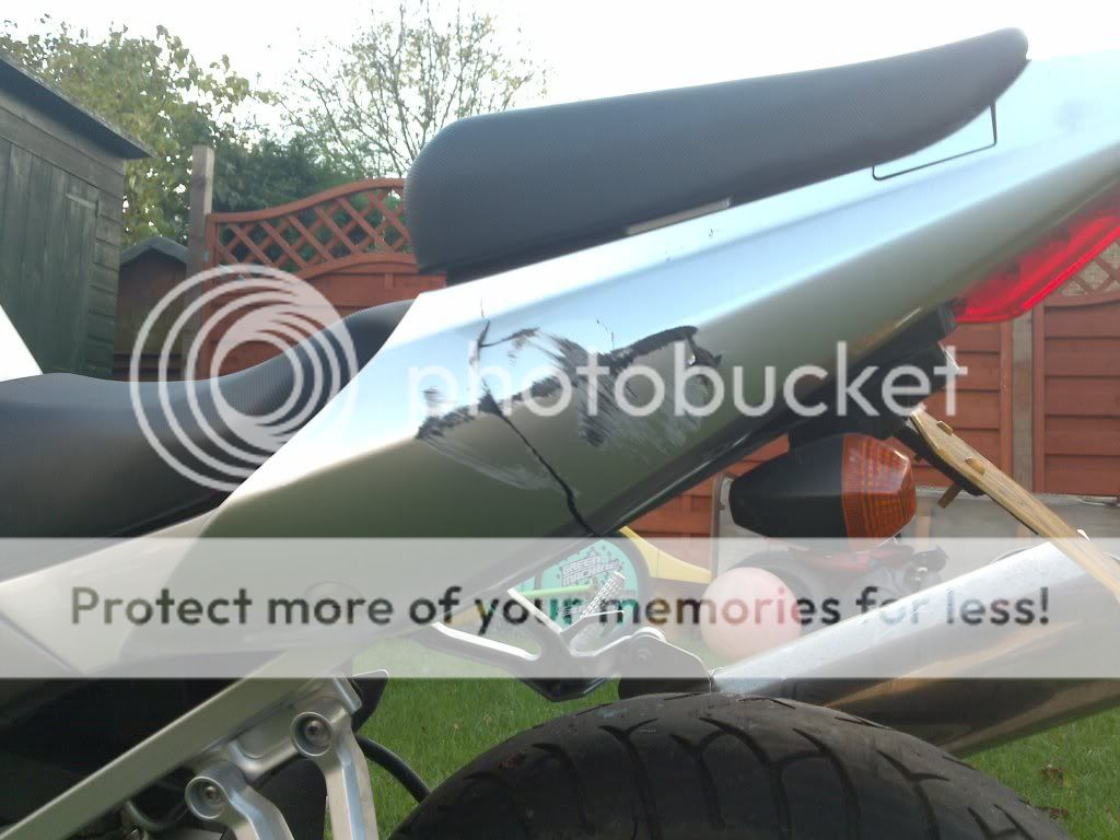

unfortunately had a front tyre blowout Wed night and now the sv is in a right state
was:
now:
poor thing.
Old 31-10-08, 06:41 PM   #2
Dangerous Dave
Default Re: Didnt even get to show her off :(
Welcome to the site....
Get a new wheel, tyre and indicator fitted mate and it will be road worthy.

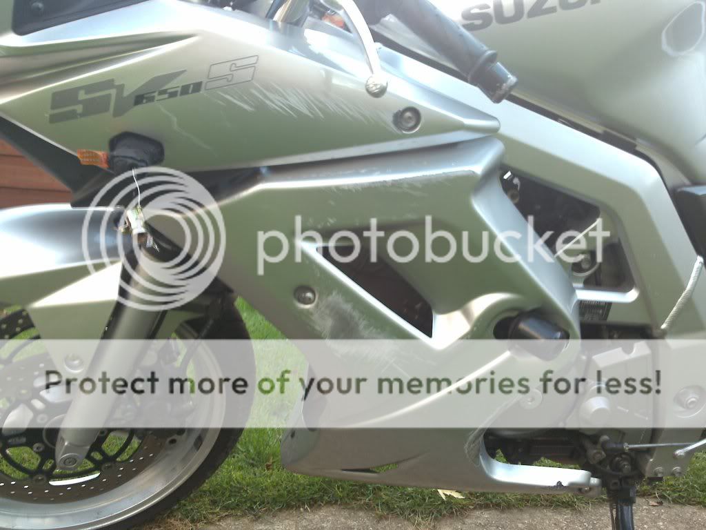

Question: what brand of slider was that bent over instead of sliding?
Those type of sliders are mounted to the lower fairing bracket which is quite flimsy, more for looks than anything as the bracket bends too easily!

get the plastics (Fairing) plastic welded, then do the respray your self, (colour code YD 8 .) , there is plenty of stuff on fleebay... and I belive this is the link you need...
hope this help, Welcome to the fold, and get that bike back on the road...
