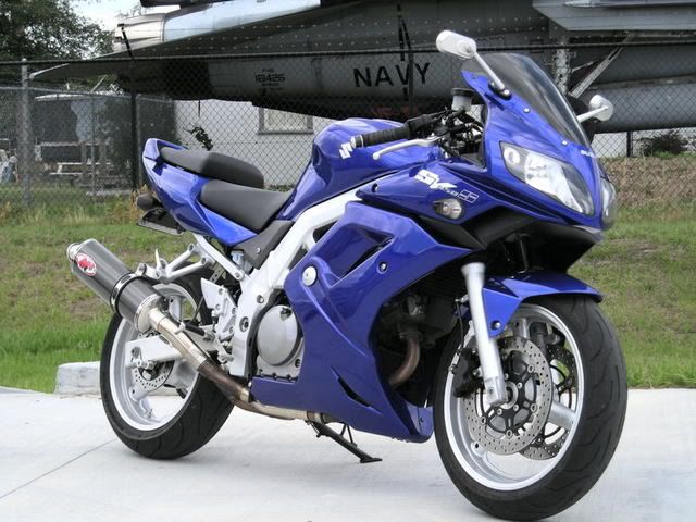

Hello, welcome to the SV...
You are missing the large bolt and washer from the side of the fairing.

thanks for pic and guidance!
just checked mine out again and i dont seem to have anywhere for that bolt and washer to go into?
is there a bracket or something that i would bolt it on to?
cheers!
Old 01-11-08, 01:20 PM   #4
Dangerous Dave
Default Re: newbie finally saying hi
There should be a brcket for it to bolt to under the fairing, its the main bracket too! It has a large round head on it which fits sungly into that hole, the the large washer (or a crash bung) fit over and are bolted to the bracket.

I would guess the previous owner had R&G crash bungs fitted to there bike, do you know? The R&G full fairing crash bungs come with a replacement bracket.

dont seem to have anything like that on there!
dont think the previous owner had any bungs or whatnot.
heres mine
i was thinking about the crash bungs, but it has been an expensive week! didnt expect to have to shell out for a new rear tyre too... I knew it was squared off but yikes. it was pretty bad.
where is best to get some? theyre about £75 arent they?

The ones you are missing are these.....
....and unfortunately you can't buy the individually new.

i have the front C shaped ones, but not the curved back ones.
Presumably by looking at the crash bungs pic, they do the same job but better and with the bung on it too?

You have two options...
1) Is buy a full fairing mount kit, personally I don't think you should do this because you have have the brackets already and it costs a whooping £116.99.
2) Is you buy the full fairing crash bungs from R&G, I think this would be your cheapest route and although I am not a fan of R&G for the SV650 you will get two products for the price of one (bungs and a bracket).
