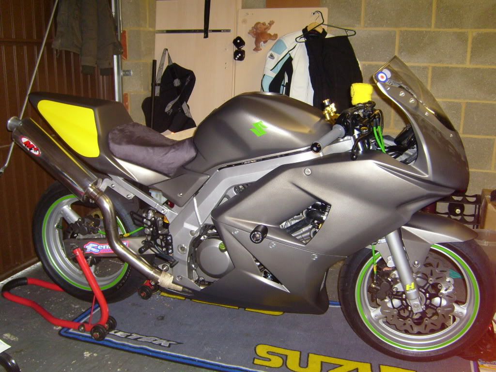

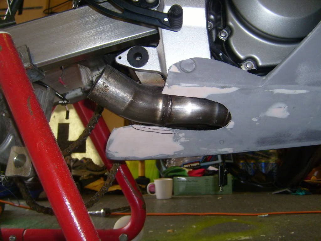

Hi mate, I bought the JHS fairings too for my first year. They are dammed good and very sturdy. Yeah you do have to cut holes for the R&G's and I had the same problem as you with the downpipe, but nothing a dremmel didnt sort. I'll see if I can find some pictures for you. Although I did still have to wrap the downpipes as although they werent touching the fairings, they were close and did scortch a little.

Nice one sideshow, some pictures would really help.

Hi mate, no I run M4 headers, but did have micron ones on my road bike and apart from the diameter they are fairly similar.
Here are the before and after pics. HTH buddy.

Wrapping the exhaust, as said above, is a good idea and it might also be worth painting the inside of the fairings with high temperature paint. I had to do this for my road bike with 2wheeljunkies fairings as the down pipe was resting on the body work, didn't burn though and the yellow paint remained blemish free.

They look much better than the fairings I had previously. Think I'll end up cutting out a very similar shape for the exhaust. And hopefully it wont foul where the rear cylinder joins the rest of the pipework, like the other one did. I'll give them a ring in the morning.
