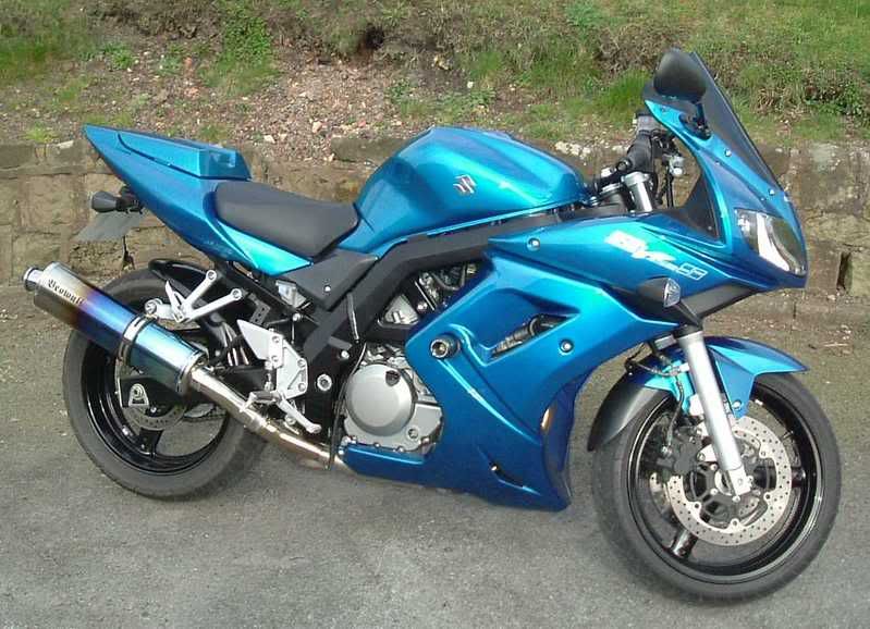

Introductions first...this is Wilma, my blue K6

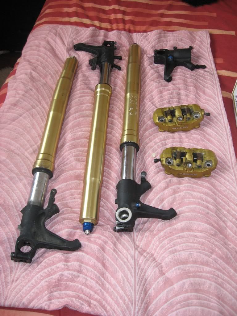

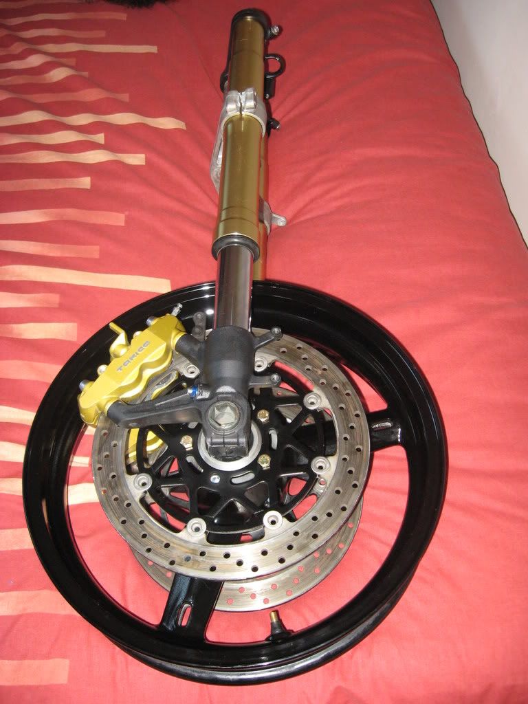

First purchase...
A pair of GSXR600K4 forks and calipers, a replacement axel mount and a GSXR750K4 'banana-fork'
As you can see one of the 600 fork adjusters has been ground off. The 750 fork was given to me by the breakers because the adjuster is in perfect condition. The fork is so bent it won't even compress!
I was planning on having the forks serviced, so a strip down wasn't going to be an issue.
I took the forks to my local shop and just for kicks asked the mechanic if he could hammer the bent one straight. You have to do these things occasionally...

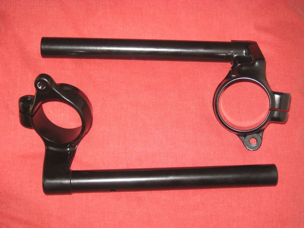

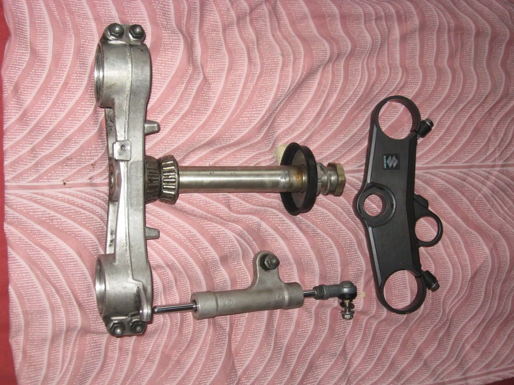

Next on the list were the yokes and clipons.
I saw a pair of TLS clipons on eBay for £26 plus shipping....EACH!!! Sod that. I found a pair for £30 delivered.
The yokes were from a GSXR1000K4. One of the lock stops was damaged, but after confirming the sellers claim that it is 'an easy repair' I bought them. Had the damage been more structural I would not have considered buying them at all.
The lockstop was repaired for £10. Total cost - £46 plus shipping.

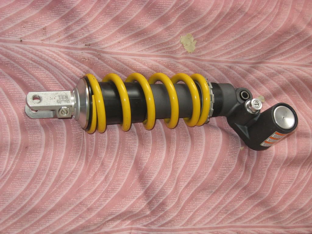

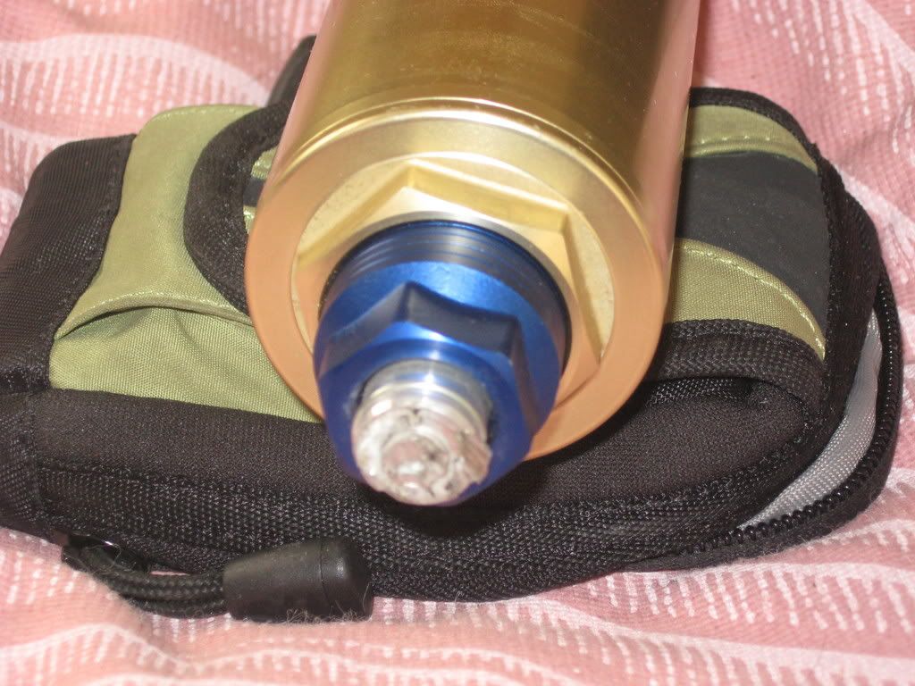

GSXR1000K4 Shock. 1500 miles. Just a few storage marks.

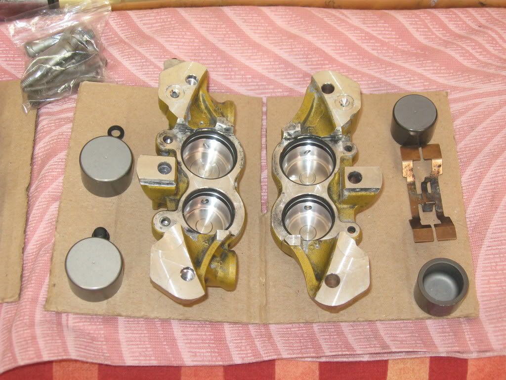

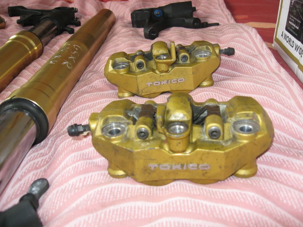

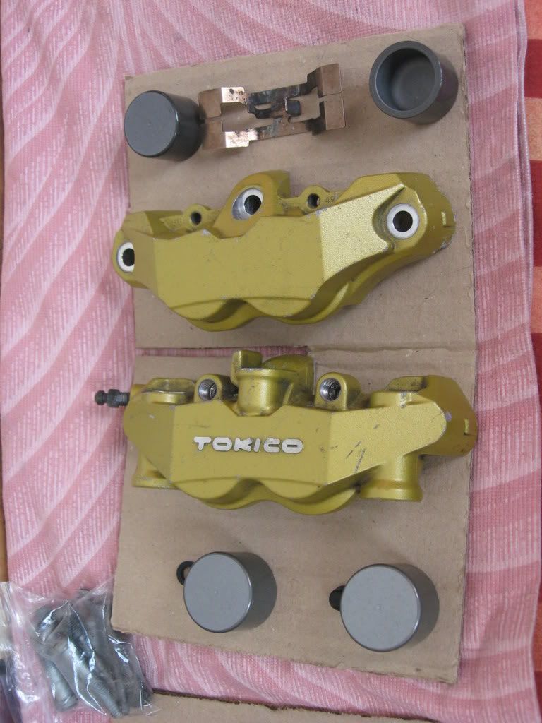

The calipers were pretty scrotty, but a bit of water and Autogym soon got the grime off. They are a bit scratched but I have decided to live with them and tart them up over the winter if the marks are too noticable.

The clip-ons have been powder coated because I didn't want silver next to the black yokes.

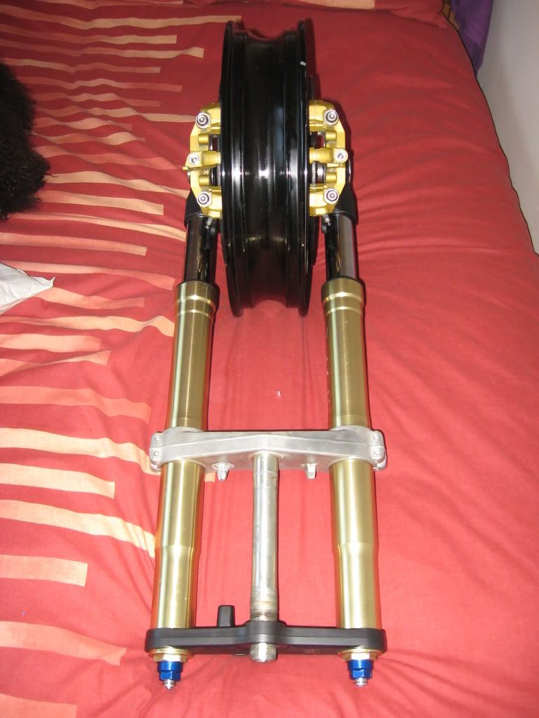

Where I am at now...
Forks serviced. Oil and seals replaced where required. Broken axel mounting and adjuster replaced. The axel mount replacement is a story in itself. Never believe a breaker when he says "Its dead easy...just unscrew the old one and the new one will screw straight on." Yeah right...with the aid of a lathe chuck, some copper strips, a blow torch and a jack handle.
Calipers rebuilt and new pads fitted
Wheel delivered - GSXR600K4...dink free apart from the cack-handed tyre removal marks that won't show, and a slight scratch that is hidden by the discs.
GSXR750 spindle delivered. Clean apart from a slight touch of road rash which you can hardly see.
Hall sensor and magents delivered...two sets of magnets cus the first set were too deep.
Discs delivered. Not great but they will do and the price was OK. I have checked them for warp and thickness and they are within spec.
Fender, Goodridge braided hoses (stainless fittings), head bearings arrived
Waiting for disc bolts and I need to order some fender bolts...
I have fitted everything loosely to see what screws / bolts / widgets I am missing. Note the very tasty M8 hex head bolts I used to line up the discs...
Still got a few things to sort out - mainly to do with mounting the speed sensor - but I think everything is in hand.
