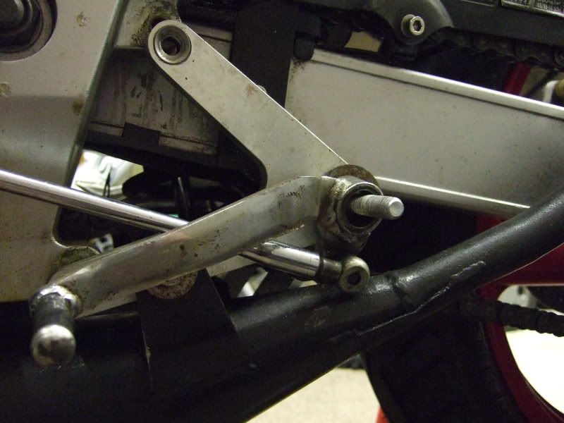

Does anyone know where I can find the spacer that goes between the gear lever and it's mounting bolt? It's off a tzr250 2ma
Inside diameter 10.05mm. Outside diameter 17.05mm. Length 26.23mm

I'd say it's a bush rather than a spacer. As the lever pivots, it really needs to be made from something like Phosphur bronze or 'Oilite'. At a push you could use anything as long as it's kept lubricated well and the lever gets regular use. Do you know anyone with a lathe who could knock you one up?

Try giving Fowlers a ring on 0117 977 0466
They are usually good for all parts Yamaha

Don't know anyone with a lathe. I've just fired off an email to fowlers
