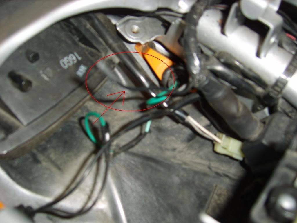

p.s there is this wire that is not connected to anything, and comes out of the loom of the alarm thingy. Is this normal? it looks like its closed at the end but perhaps it was a spade connecter thats broken off or something??

Old 22-04-09, 09:07 PM   #5
RatchetJob
Default Re: Alarm issues
James,
That wire might be the "aerial" used to pickup the code from the fob.
When the alarm goes off you can diagnose what caused it.
If the alarm goes off it will emit three beeps as opposed to two when you disarm it. If this happens the LED will flash a code telling you what set off the alarm.
