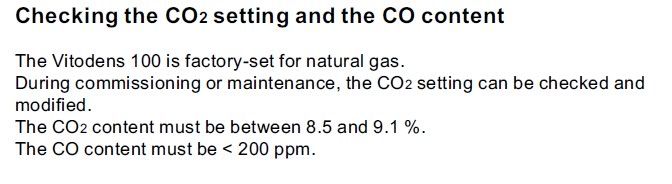

Funnily enough I was looking through an installation doc for a boiler yesterday. This is a Viessman but I'd guess it's pretty typical for gas combustion.

At 400ppm the boiler should be stripped down and serviced, as stated in gas safety regs, and in accordance with manufacturers instructions. 100ppm is fine especially if standard efficiency not high efficiency. CO2 ratios will vary with manufacturers but as a benchmark 9.2% +/- 0.5% will generally put you in the ball park.
