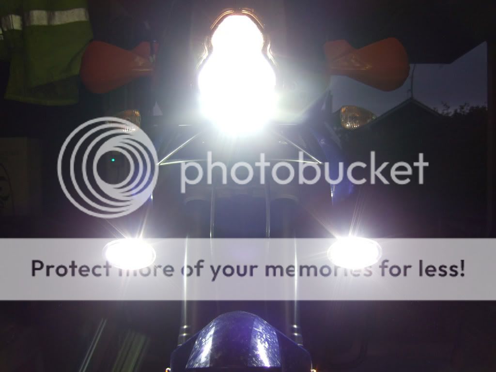

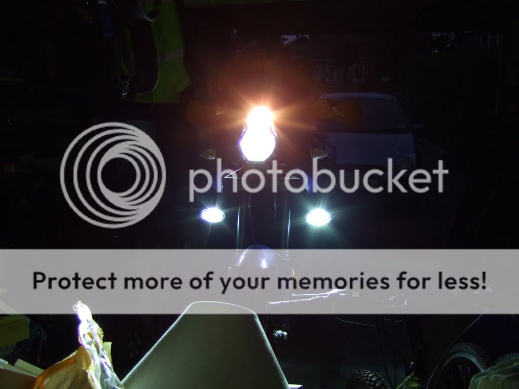

35W is significantly brighter than the best halogen bulbs, on unlit roads they are fantastic, high beam is better, low beams tends to make the foreground brighter leaving the distance harder to see. I've had kits that do and kits that don't require relays, try without and if it pops the fuse then fit a relay.
ETA: No thread on HIDs would be complete without a bit of pic whoring...
(•_•)
( •_•)>⌐■-■
(⌐■_■)
Deal with it...
