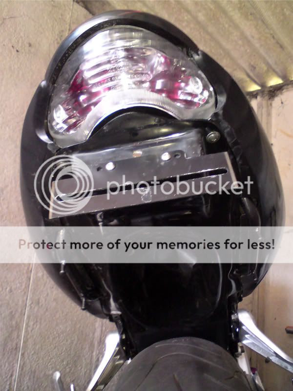

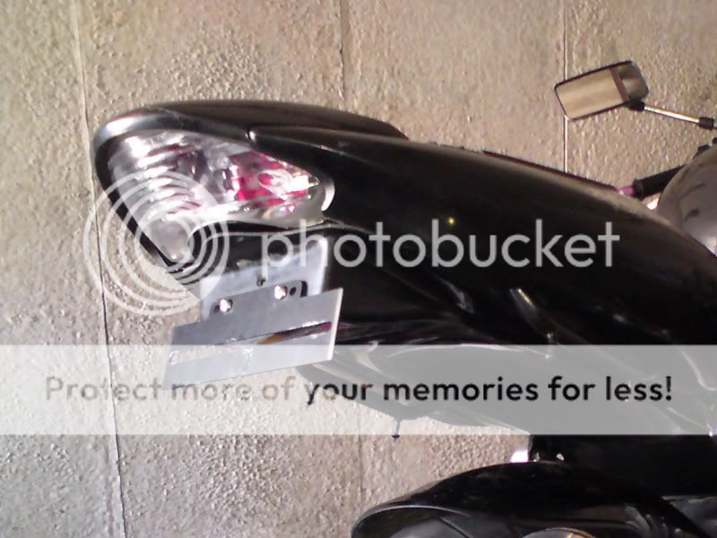

Default Re: Curvy undertray fitting?
Mine was a cheap one from ebay the fit wasn't great but its more or less the same shape etc as the proper ones.
I used one of these plate mate brackets http://cgi.ebay.co.uk/OXFORD-PLATE-M...item5882c9082f Which is adjustable and has indy bits etc as you can see in description on the link.
Drilled three holes two small ones to bolt on the main bracket (do that before you fit tray to bike as its easier IMO) one slightly larger hole for all the wiring for the indys and number plate light to come through.
Then using indy brackets that come with the plate mate to mount the indys etc. Then two bolts through the whole lot to mount the numberplate indys etc to the pre fitted back plate and the jobs a good'un
Hope that is of some help.
