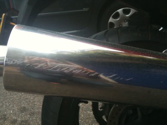

Cheers, Good summary. The bike looks totally standard even down to the exhaust. The seller has sent me a pic though of some damage to the exhaust where it has obviously been on the floor at some point with parallel scratches. I will try to post it via photobucket in a minuite so you can take a look and let me know if it is accident damage or just someone has dropped it at some point. I don't mind being dropped but if it has been sliding along the floor that is another matter.

Pic sent to me with the exhaust damage. Doesn't look too bad to me but I am no expert.
