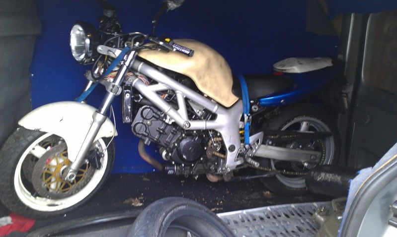

hardhat_harry
Default Re: Spring Curvy SV rebuild project underway!
Here is mine I have build from bits I had lying around and bits I picked up, even rebuilt the top end off the engine.
GSXR600 Front end
GSXR 750 rear shock
GSXR400 Calipers
LC Headlight
Koso DB02R Dash
Pictured in my van as I'm off to my mates engineering place to manufacture a link pipe for the high level exhaust.
Needs the wiring tidying up and some paint and its good to go!!
Old 15-02-12, 12:10 PM   #8
SVmonkey
Cool have you already started a thread with pics to show start to finish?
What's the deal with the tank, looks like plasticine?
Old 15-02-12, 12:19 PM   #9
hardhat_harry
No couldnt be arsed with a build thread just got on with it when I had the time.
Tank had a couple of small dents and was very rusty (i was given it free from the org) so they have been pulled out, lightly filled and the rust removed, then primed and spotted (spotting is the term we use to put a light spray of a dark colour over the primer so when you are flatting the primer the dark colour gets removed and you can see where you have flatted).
When I get the topcoat paint I will use flat it back and it wont look like plasticine.
