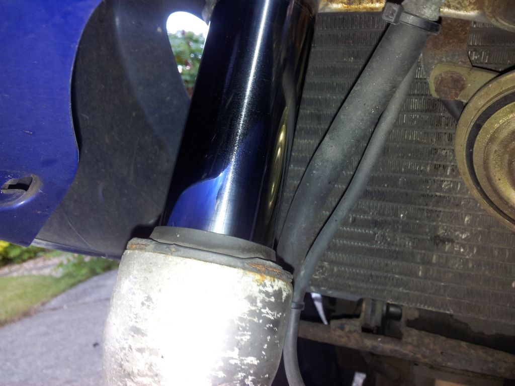

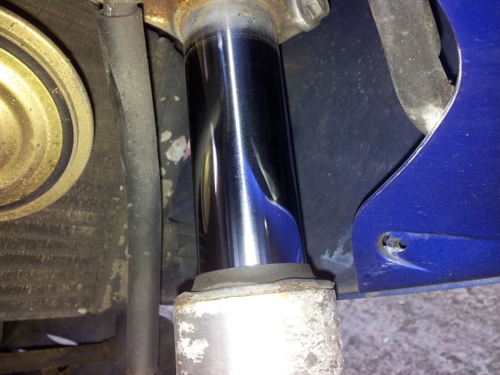

Right, Took a look at there was no clear indication of a leak on the forks and I tried to take some pics

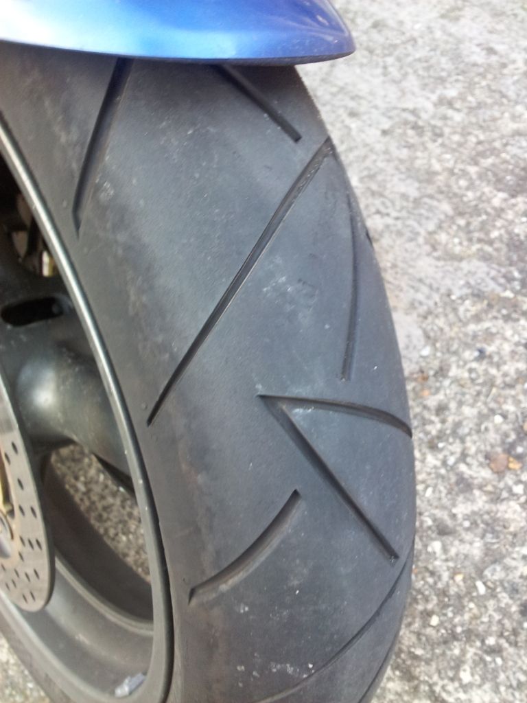

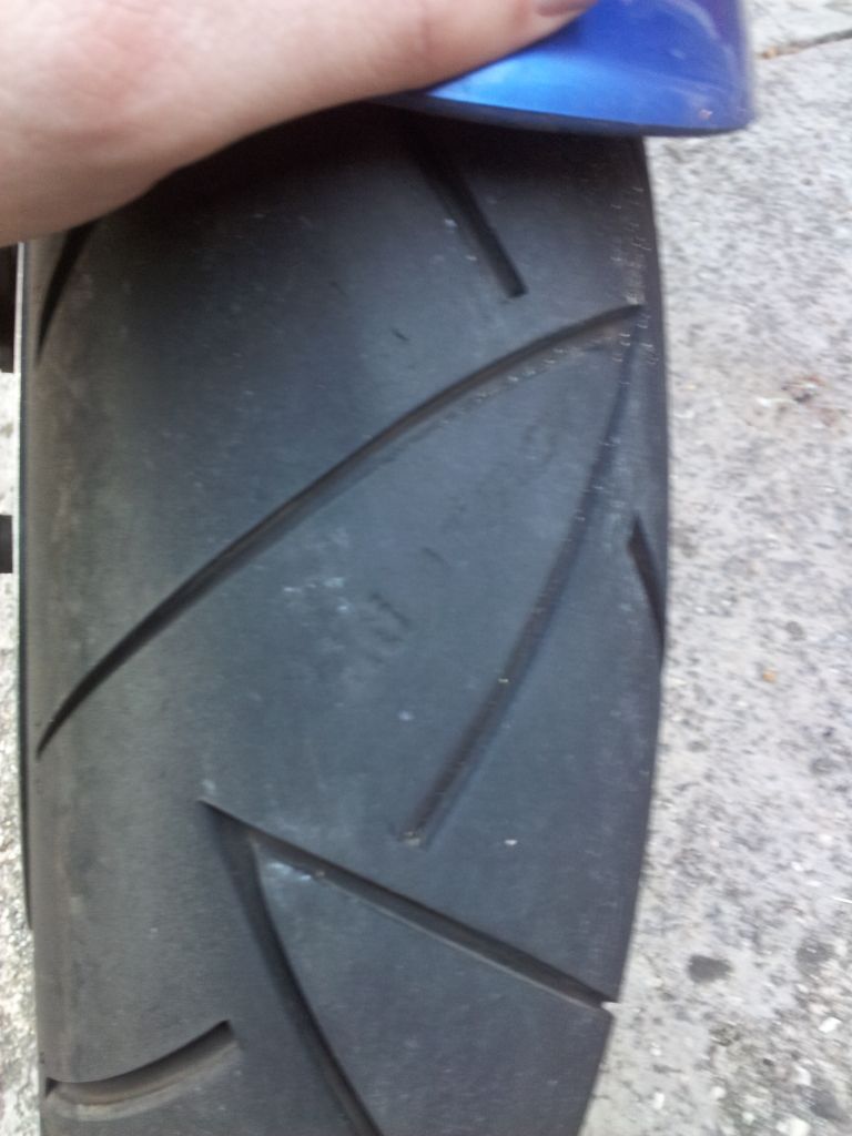

Also took a look at the tyre again and it doesn't seem too bad but here we are maybe you can tell me

Old 14-09-12, 05:39 PM   #9
