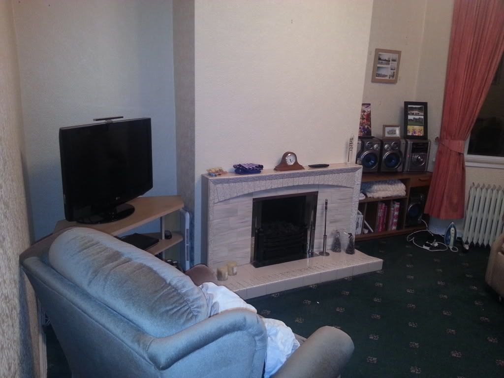

Hello OMO,
Just looking for some advice really.
I currently have 2 fire places(dining room and living room)
both were open fires at one point one now has an enclosed fire place (real 60's) with an electric fire mounted.
the other is still an open fire hole in the wall.
i wish to put 2 log burners in? both have there own chimny.
Does anyone have any first had expirence fitting or of a fitter i can have a hassel free chat with.
Tom.

im trying to upload some photos. the gap is mostly bigger in the living room then it is in the dining. this would also be used more.
i am aware of certain costs but i can see them just getting bigger( expected tbh)
