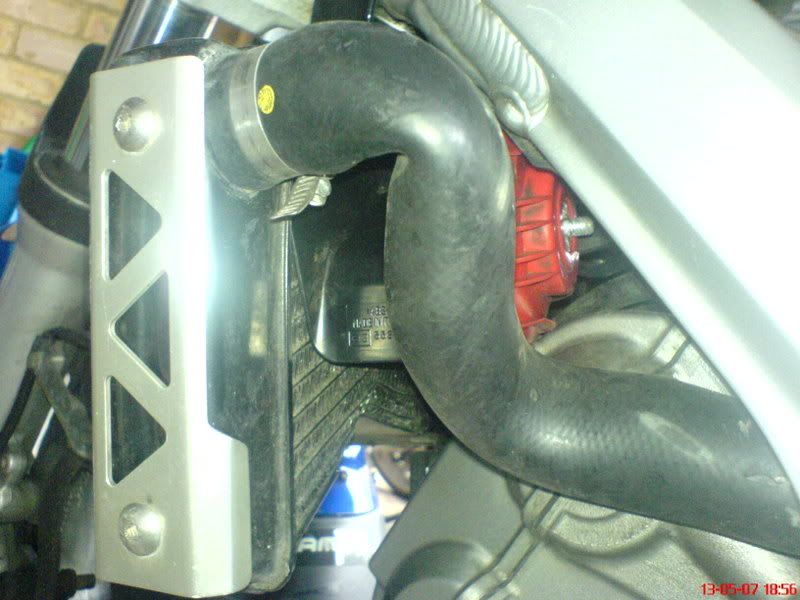

A not so well known issue is that the horn gets too hot. The location for the stock horn is pants (behind the radiator - yeah, great idea!).
I solved this by getting two Stebel Magnums (mounted off the lower side bolt on the radiator - air cooled ) and two air horns (mounted inside the fairing, with the compressor under the pillion seat.
