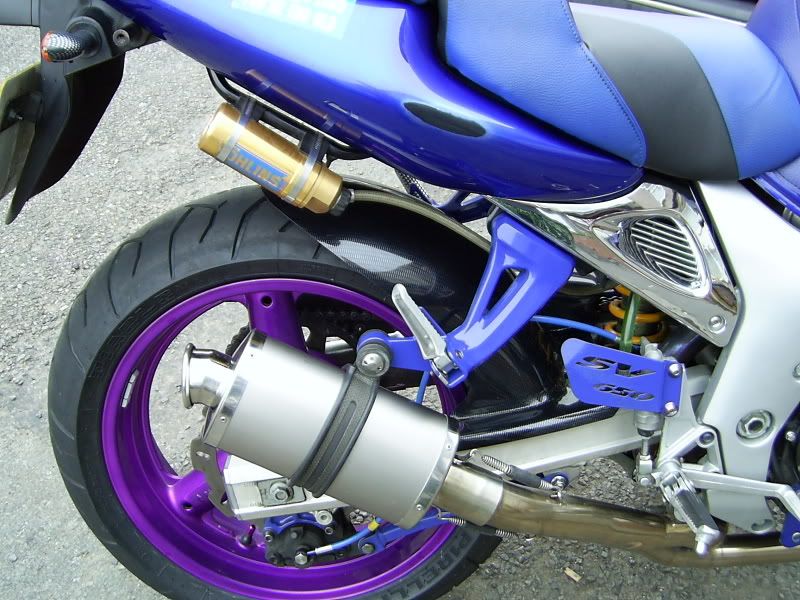

We have a full titanium system, and while you can polish it up to some extent, I've never been able to get it to shine like stainless. However, we had a titanium stubby which had a brushed finish and that has polished up to at least match the rest of the system. Still not the eye-aching shine you can get from stainless though!
Before
After

Nice looking ar*e there Lissa (apart from the graze that is) like the pillion pegs and caliper brace.

Cheers Mark
The pillion pegs,etc cost 20 quid to have powder-coated, cheap as chips
The graze is from 60,000 odd miles of my legs rubbing on the paintwork! Bloody pillions, eh?
We will get round to replacing the seat unit one day, but hey, it's battle scars honourably won
Talking of scars.....................how's your knee?(Derail)
