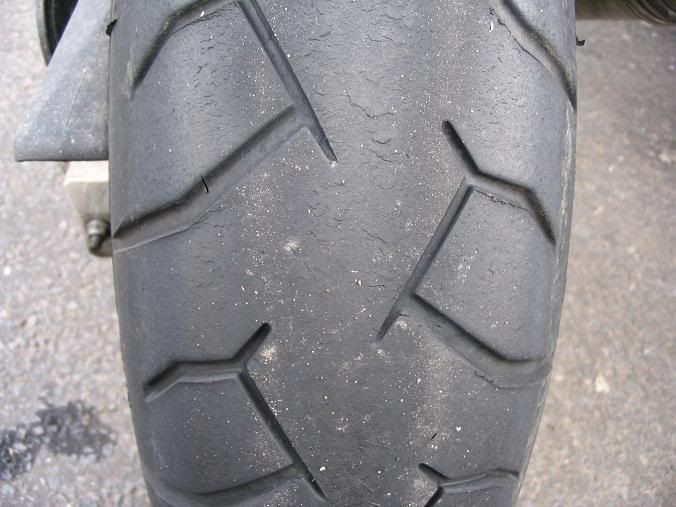

Default I don't think my tyres should look like this (see photo)
I guess my first step is to go check my tyre pressures. But I've no idea what this is or what causes it. They look like cracks but I'm not sure they aren't little rubbings or rollings of rubber?
I noticed this whilst in the services on the way back from the AR. Had been doing a steady 85ish for ~40 miles at this point.

My Diablo Corsa III's looked like that after along spell on the motorway on the way up and back to the North / South rideout.
I think its just the rubber graining off the tyre.

I THINK its safe to say nothing much wrong with those tyres.
Had something similar (very similar I think, but hard to tell in a piccy).

That could be low pressures- I had a valve stem jam slightly a while back and rode a few miles with pretty low pressure (how is it that people miss this btw? It was like riding in treacle...) and the tyre looked like it was straight off the racetrack, properly glommed up. But equally, it could just be one of those things, personally I don't expect to see it on motorway use though.

Default Re: I don't think my tires should look like this (see photo)
Ditto - my stock tyres looked like that when I was packing up from a recent trackday. Bloody unnerving driving around the backroads on the way home as the bits got slowly worn away back to a "normal" road condition.

Looks like the kind of wear you get on the edges of the tyre on a trackday. I've never had on the centre though.
I thought the tyre grained on the edges as it has 2 forces acting on it, accellerating and cornering, at the same time. Obviously not.
Tyre pressures is definitely the first place to look. Suspension can also cause strange tyre wear but as you were on the motorway I doubt it would make much difference in your case.
