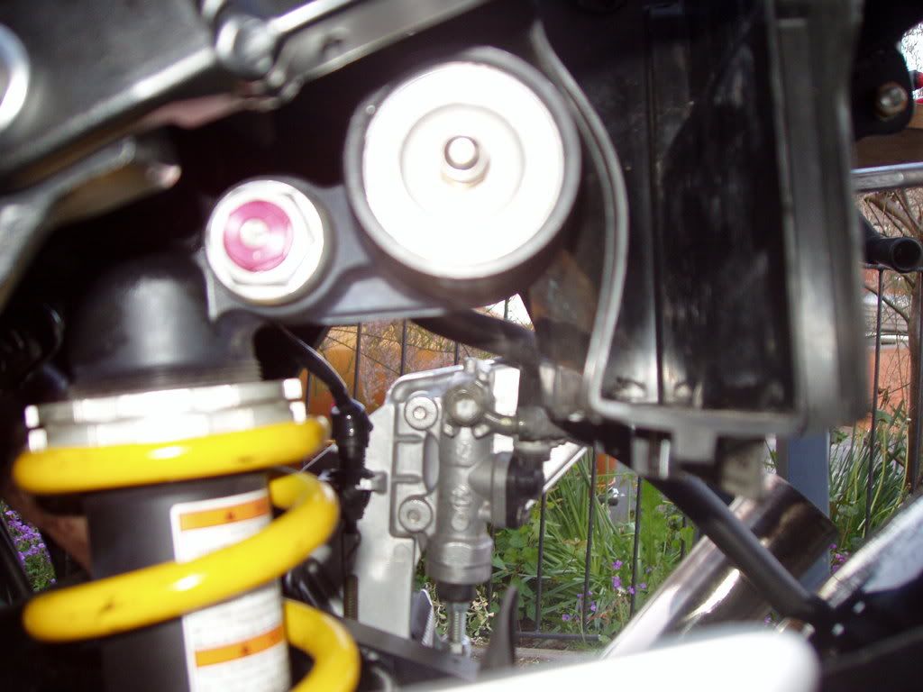

Originally Posted by silent11 View Post
gsxr 750 k5
that does not look like 05 but 06/07 which is totally different.
ive just quickly scanned through this thread and just wanted to mention that the battery box doesn't need to be cut AT ALL, its just the slightly easy option
all you have to do is move the under tray back, this is the reason why the mod needs to be done
that pic was taken before i moved the undertray back
i basically moved the undertray back, which moved the battery and tool box back making clearance for shock

Originally Posted by Miles View Post
Have you got any pics of how you moved it back and what it looks like now?
i havnt got any pics of yet ill get some tomorrow for ya

borrowed this from another thread as posted by miles:
Nut - 09159-10115
bolt - 09103-10143
are these the correct partnumbers for the gsxr shock bolt & nut to fit the gsxr shock to my k5 pointer? and is it something I could get from suzukispares?
Old 23-10-08, 09:50 PM   #100
Bibio
Bibio's Avatar
Posts: 11,569
Default Re: the shocking truth about shock absorbers... (noob questions as asked by myself)
yes ..
http://fiche.ronayers.com/Index.cfm/...CUSHION_LEVER_
you also need to turn the bolt round the other way from original shocky (looking from back of bike insert right threw to left)
if you don't then the nut fouls on the linkage... i know i have done it... i also ground the nut and bolt down a little but i never needed to...
you can get the parts from any suzuki dealer
