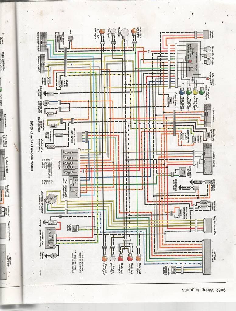

Default Re: K3 wiring diagram
hope this helps can get better scans if needed

Quite a bit got changed around when fitting your new instruments, I seem to remember arranging some extra connections to your new instruments as they need a permanent live to keep the clock alive, it's possible that the red you can't identify is that one.
What's amiss?
I changed out the main loom for another and in the process had to strip the connector blocks. All the connections are now in the headlight bowl by way of soldered joints.
I thought I followed my own previous instructions correctly but started having issues. The first was that the fuel light would not work. The clock resets after the ignition is switched off. A couple of days ago, I lost all clock function and the bike died. The electrics came back on to the clocks but the battery was dead. I had to bump start the bike. Unless the battery is fully charged all the time, I do not have enough power to turn over the engine. I assume I have wires crossed somewhere. For me it would have been a simple case of tracing the clock wires on the pointy wiring diagram and relating them to the same wires on the curvy and splice them together.
Oh and when I put the brakes on the side light bulb glows dimly.
Trouble is, the wiring colours shown coming from the pointy clock is not the same colour wires as I expected to see. I can only think that the wiring loom that plugs into the clock must have come from a different clock. Hence the question about different versions of the wiring diagram for the pointys.
I thought it was going to be easy, I should have known better.

Originally Posted by ad53ggz View Post
they appear in the k1 and k2 i think scanning them now and you can have a look
I thank you very much for your efforts. I should have pointed out it is a pointy clock wired into a curvy.
