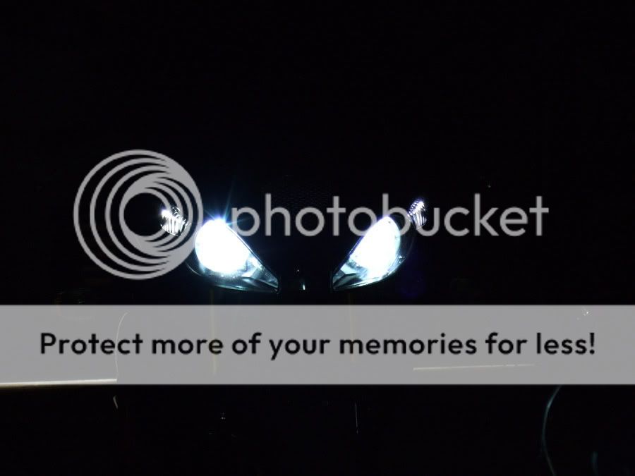

6000K are fine, they aren't purple, they're white, with the tiniest hint of blue, 4300K are best for max light output but 6000K put out 95% of the light and look much cleaner, you only start to get seriously purple lights (and crappy light output) at 8000K+:
The LED sidelights on my Daytona are white, the low/high beams are 6000K:
