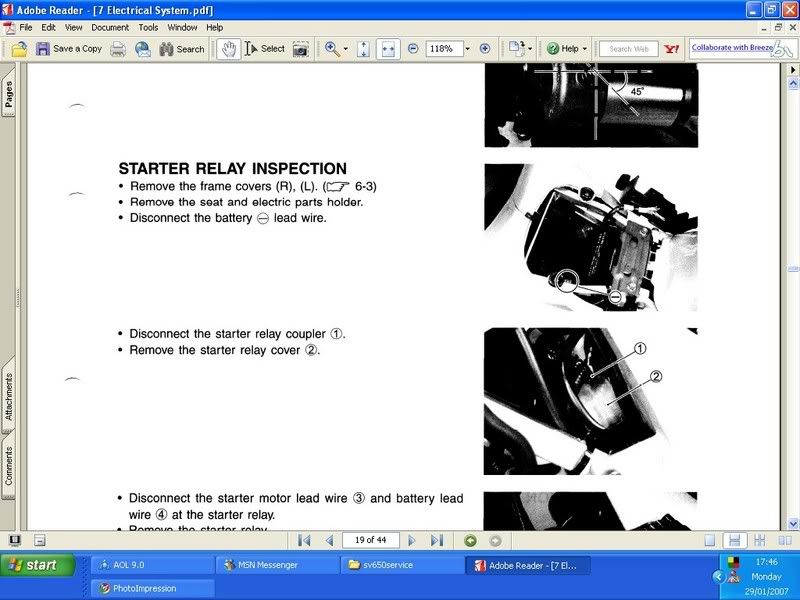

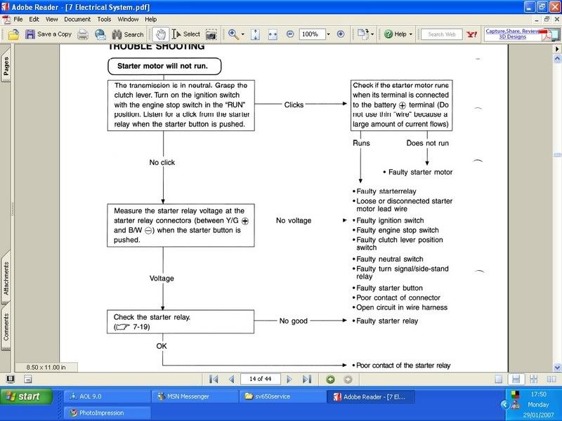

The starter relay is , apparently, under the right hand vented cover. In the Haynes manual it shows two 30 amp fuses. 1 is a spare I presume, so check there. Also some info that might be handy below.

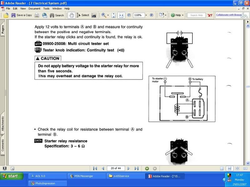

oh-k I am still testing the relay (believe it or not) and I was just wondering: In those terrific (much thanks by the way) abode documents that was sent I am told to test the relay by taking it out and running 12 volts through it. I don't have such equipment for this so I was wondering what your thoughts on just drawing this energy directly from the bike's battery were. (would it fry the relay)
