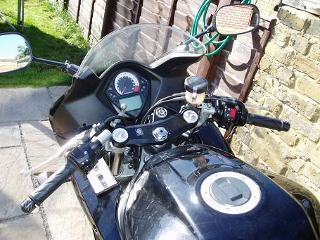

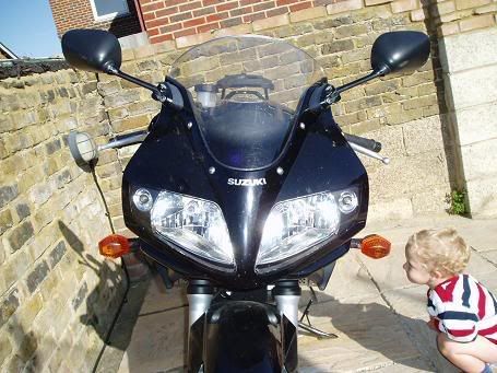

Here they are. Yes, it's hard to see where the £230 odd quid goes, but you could say the same for a bit of bent metal (end can) which someone will happily spend a few £100 on, or plastic/anodised tat which people spend loads on: neither of those improves the comfort or handling of the bike, so I reckon the helibars is some of the best money I've spent on the SV so far, the only one that betters it is the R6 throttle tube conversion which wins mainly because it's only £8 or less to do.
View from the front - deceptive - the bars are almost as wide as the mirrors in reality
From behind, you can see the bars stick out more

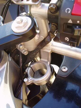

In this one the old clip on bar is in line with the helibar (though below it) and you can see where the old bar would have to fit on the bike to give the same grip location as the helibar does, about 2 inches further back, plus the helibar is higher, about one inch.
It doesn't seem like a lot but it's enough to make a difference on the road and any more than that and you'd need to replace all the brake, clutch, throttle, etc. cables.
