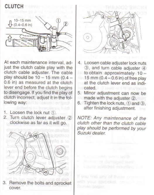

I see, the books get lost over here too. I forgot about the used bikes sometimes not having them. So here you go.

Sid Squids explanation somehow puts it better I feel.

Cheers Jimmie...slightly blonde qeuestion:
So, I don't need to hold my clutch all the way into the bar so change gears? Seems kinda wrong to me....
Old 03-10-07, 08:12 AM   #17
John Burt
Default Re: Clutch woes! Advice needed....
Yep, that right just pull it in far enough so that the clutch disengages the drive.
Old 03-10-07, 09:22 AM   #18
Ceri JC
Yes, he's right. It feels odd to begin with, but when you get used to it, you'll wonder why you ever used to pull it in all the way.

This is all well & good for folk with long digits but if you have short square podgy hands and fingers like me then reaching all the way out before the clutch bites is a pain in the ...erm...wrists? Very bad in stop-go traffic with lots of clutch work. When I first picked the bike up the clutch started biting when the lever was around half way out and was was fully engaged by about 2/3rds. This was comfortable for me but after the first service some numpty must have altered it to the text book setting and I kept revving the crap out of the bike pulling away from the lights for the first few days, till I got used to it.
Problem is see, I don't have text book hands!!
Old 03-10-07, 11:55 AM   #20
jambo
jambo's Avatar
Join Date: Aug 2003
Location: Croydonia
Posts: 5,376
you can add extra slack in the cable if needed, but the clutch mechanism by the front sprocket should be adjusted properly
